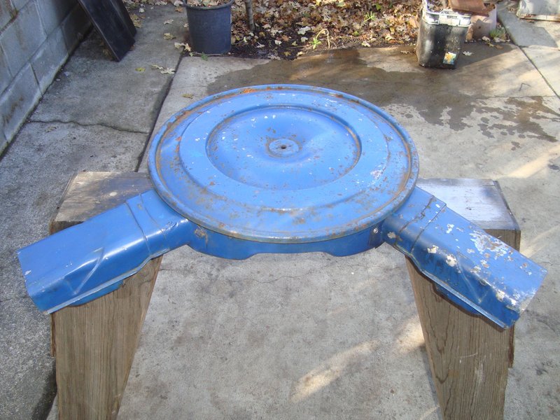

Yes, valve covers were painted.
If color is applied to the engine components uniformly, it will appear stock. Having different shades on the same engine will not look stock.
This is "stock"
So is this color... you can see someone shot the right air inlet with a slightly darker tone but underneath is stock.
