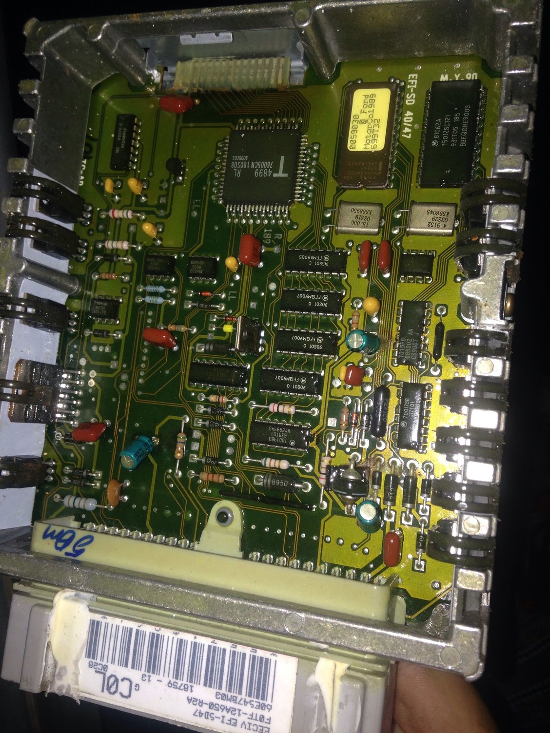

Well I'm quite proud of myself. I figured out using jumpers from pin 19 of the connector to the shift solenoid 2 wire that there is indeed continuity. Nothing wrong with the wiring harness. So does that leave only computer? I notice a capacitor inside looked like it leaked. Not burnt really but doesn't look particularly great on that computer board.
board.
