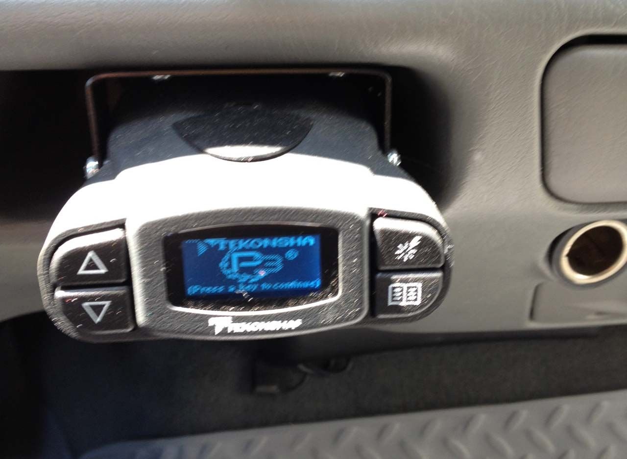

I have done low and also cobbled in dash cubby. There really isn't much available when it comes to options and fewer still if you have a digital controller with a front screen readout. Right now I live with cobbled.

I used the cubby and drilled through the back for the pigtail. Since I am using a P3 all the controls are on the front as is the read-out so I like the function, but the OEM's are certainly neater.

Here's a graphic. It is nothing impressive and lots of folks on FTE have posted similar over the years. Putting it down on the dash on the side of your right leg looks neater, but I regard it as less functional in an emergency and much harder to see the readout as you have to drop your eyes. I regard position as a matter of personal preference.
I always choose higher end controllers with read-outs as the diagnostics provide instant feedback if something goes amiss, but they do cost a bit more! I just drilled a hole through the back of the cubby to run the pigtail to the plug. If you decide to do something like this, there are wires back there, so drill with care.
Steve
P3 in cubby of 2002 PSD
