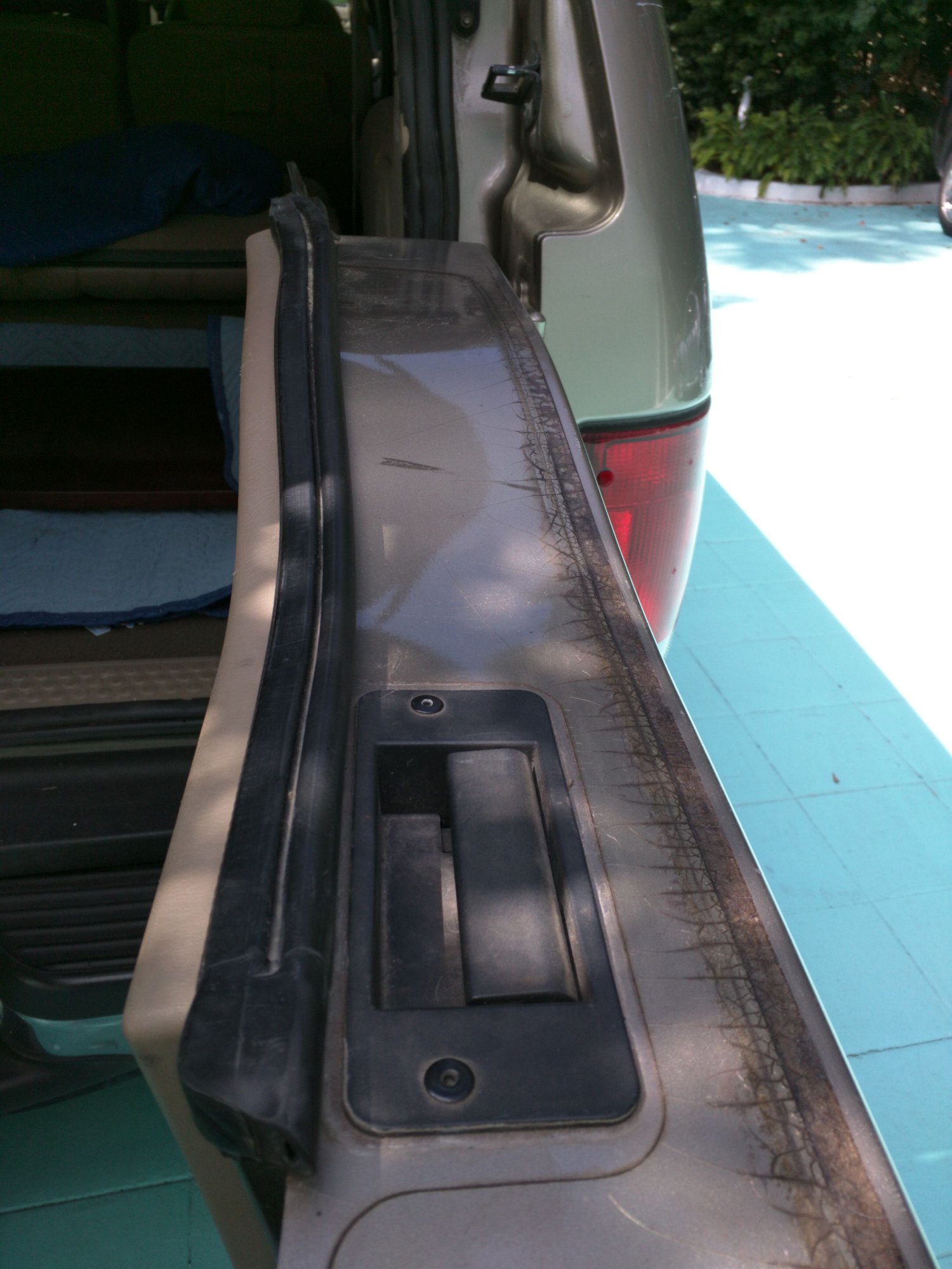

My left rear door handle broke awhile ago and now the steel latch cord that released the door came apart the other day so now I dont have a way to open the read door.
Has anyone had to replace that handle and latch cable, and if so where did you get your replacement parts?
Tried googling and nothing relevant came up.
Also, I'd like to replace the plastic cover piece on the rear glass door.
Is that possible or since the truck has been out of production for so long that part is long gone?

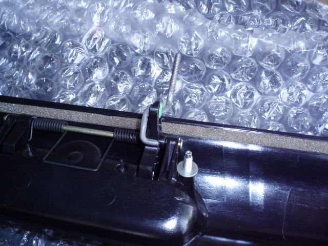

Mark just replaced the rear trim panel assembly:
Originally Posted by mecdac
This always peeved me
Six nuts attach the assembly
outside
Lock cylinder
Handle rod
All better<br/><br/>Part number: 5C3Z*7843400*AA
