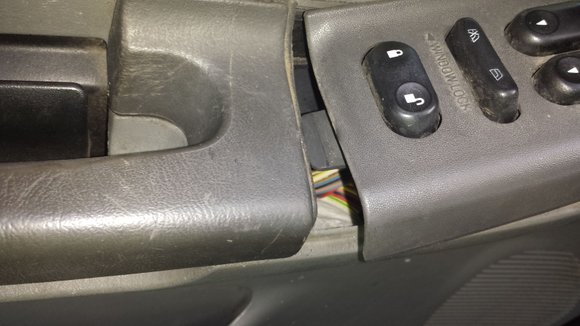

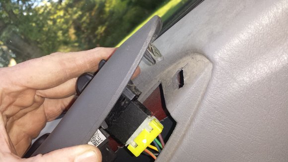

Remove the window/lock control panel. Again, it pulls up and out easily.
..and unplug the 4 pigtails and remove the panel.

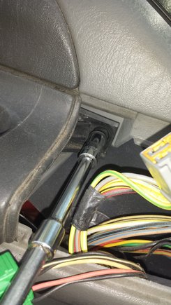

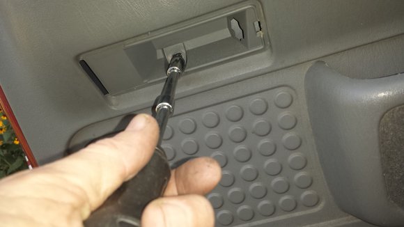

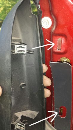

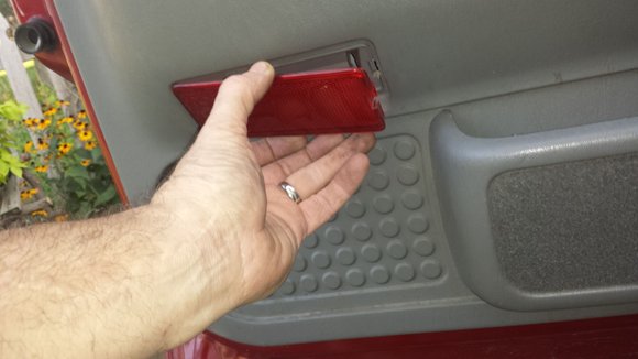

remove two 7mm bolts, one behind the window/lock control panel and one behind the red door reflector:
the door panel then just lifts straight up.

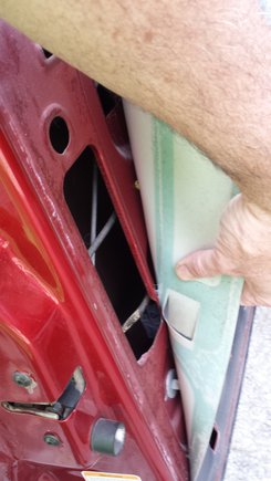

Next, carefully peel back the moisture barrier about 4-5" exposing the door handle access hole on the top left corner of the door.

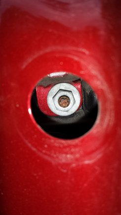

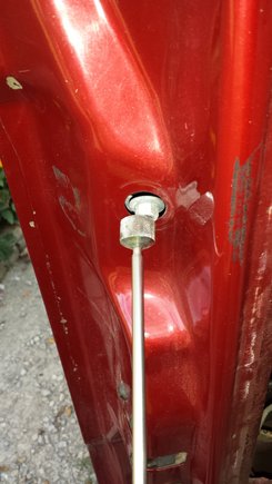

remove the rubber plug exposing one of the two door handle mounting bolts:
here is the mounting bolt beneath the plug:

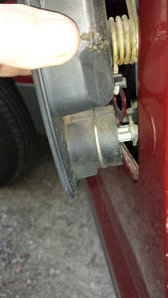

CAREFULLY remove the nut. I was able to loosen it completely but it would not come out in my socket, so I used a magnet to pull it out.

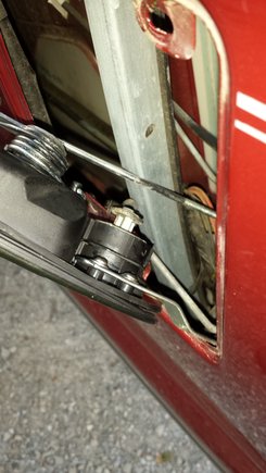

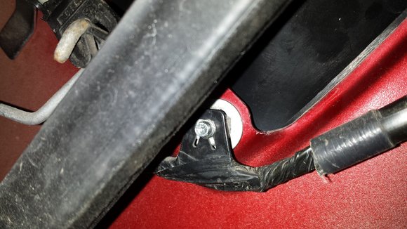

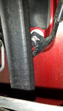

The mounting bolt on the bottom/right has a wiring harness attached to it, pull it off and remove the nut:

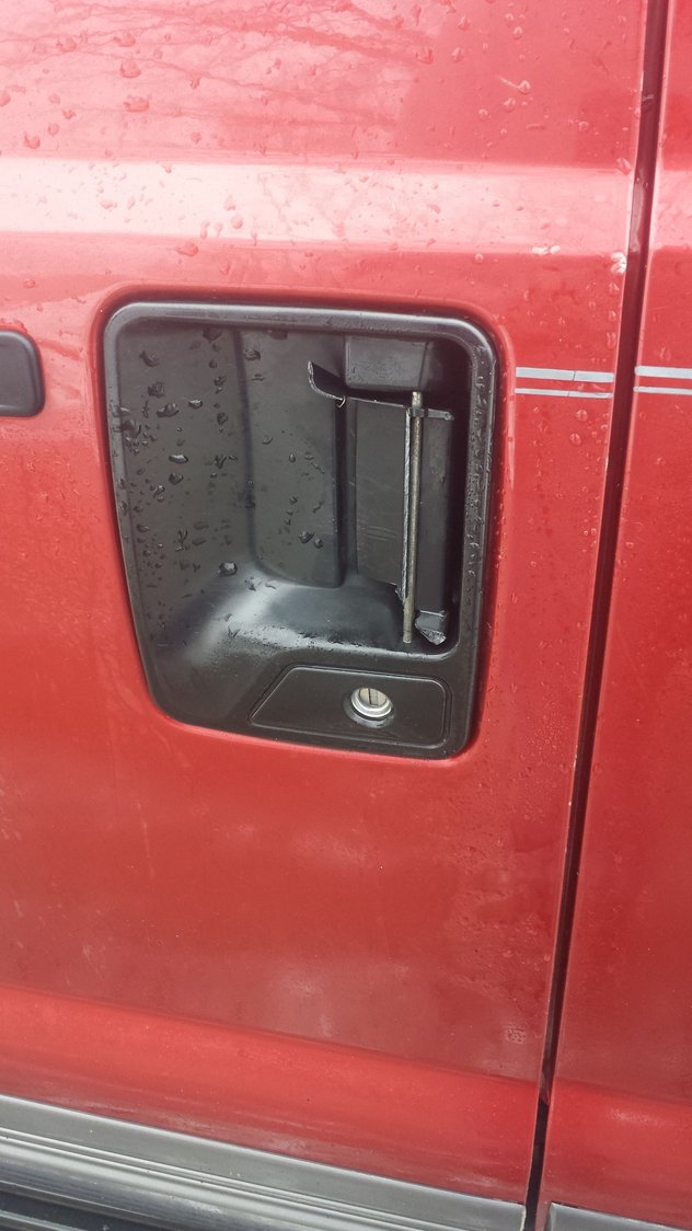

Now, working from the outside of the door, pull the handle out:

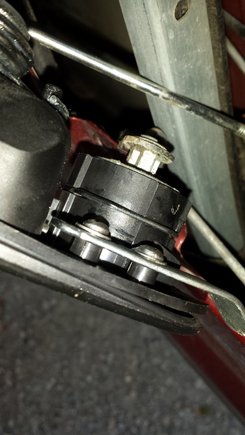

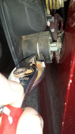

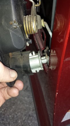

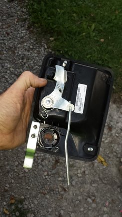

expose and remove the lockset:

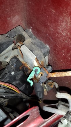

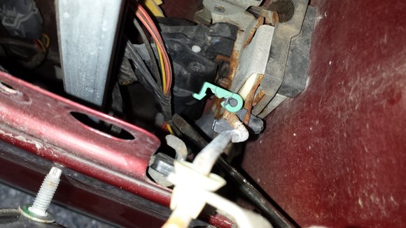

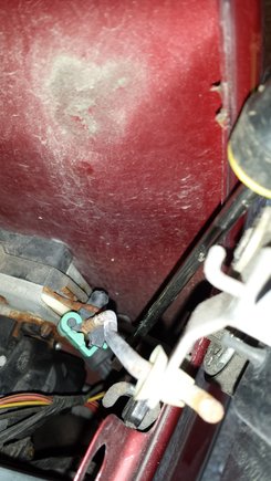

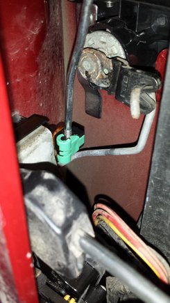

remove the door handle actuator rod from its bracket, it simply clips into the bracket with the green clip in the picture. Take a long skinny screwdriver and pry the clip loose.
remove the actuator rod from its seat:
remove the handle and here's the opening:
the new handle ready to go in. Notice that it has a mounting assist tab on the bottom left, you may actually find it in the way, I left it in place.
Replace the lockset first:
lockset with clip in place:

Then secure the actuator rod back into its bracket. I found that it was easier to lock the green clip into place from the inside of the door.
Check handle operation. On my first attempt, the door wouldn't open. I found that the handle actuator rod was mounted too high in its bracket.
If the door operates properly, replace the other mounting nut, replace the wiring harness on the lower mounting bolt.

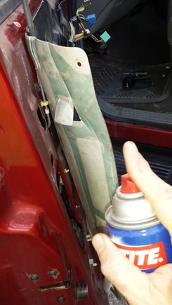

I re-glued the moisture barrier with some Loctite spray adhesive.
Spray both surfaces and let it dry for a couple minutes before pressing the barrier back into place.
