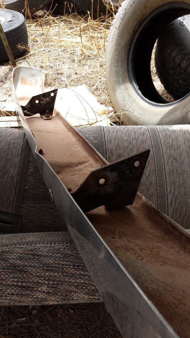

I have a question for some of you more experienced guys. I've come across some brackets for a front bumper, and I know it fits my 73 highboy, but not my 79 f150. Both are 4x4, and obviously one is a 3/4 ton, the other a half. Did ford make a specific bracket for the front bumper of these dents on highboy exclusively, and if so, are they worth anything?? Thanks in advance!

The brackets were used to space the bumper forward to clear the leaf springs.

Highboys and other 4x4 dents have different width frames!
True, but only in the rear. The frame is the same from the rear cab mounts up to the bumper
Old Jul 26, 2015 | 11:30 PM
75Three90's Avatar
75Three90
Joined: Dec 2009
Posts: 3,452
From: Santa Fe Tx
Hmmmm I thought the front was different as well?
Old Jul 27, 2015 | 12:04 AM
Ranger1975's Avatar
Ranger1975
Joined: Oct 2014
Posts: 39
Nope, they are all the same. From the "Highboy" info thread
# Highboy Frames #
Highboys have a unique frame, not shared with other trucks. Like the F-350
frame, all Highboys have a narrow frame, which is 33.5-inches wide. Sixth
generation (1973-1979) F-series trucks had wider 37.5-inch rear frame
rails, except for the 1973-1977.5 Highboy frame and the 1973-1979 F-350
with 139-inch wheelbase. This frame rail width is measured directly
behind the rear bumper, from outside of rail to outside of rail. The F-350
frame was narrowed for duallies. The Highboy frame does not bend to the
left or right (unlike the other F-100, F-150, or F-250 frames), though it
does bend up and down to accommodate the cab. A front crossmember,
positioned just below the front bumper and visible while standing in front
of the truck, separates the Highboy frame from the bumpside F-350 frame.
No other truck had this crossmember. Since Highboys have a frame that is
different from other F-series trucks, Highboys require different beds than
other F-series. The Highboy frame was never used on another truck. ##############################################
So on the highboys the frames are 34in throughout , where as the non-highboy trucks widened to 37.5in in the rear.

I know they're the same width up front, up until 78 or so. Does anyone know if these are worth anything? I can't seem to find anywhere that sells them. I have three sets now from parts I've been acquiring, but won't need two.

Does anyone know if these are worth anything? I have three sets now from parts I've been acquiring, but won't need two.
I'd put one set on E-bay and see what they go for.
