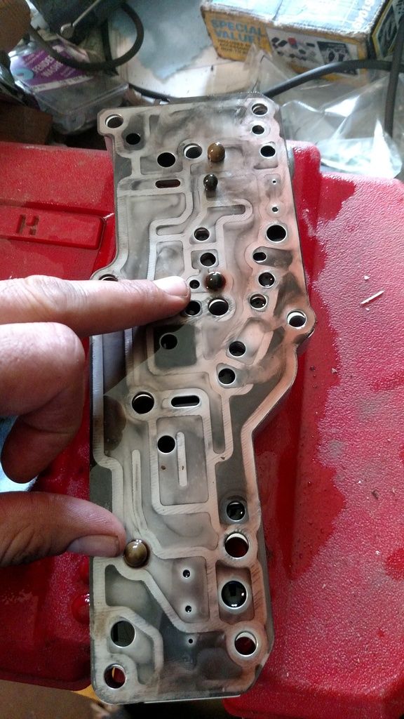

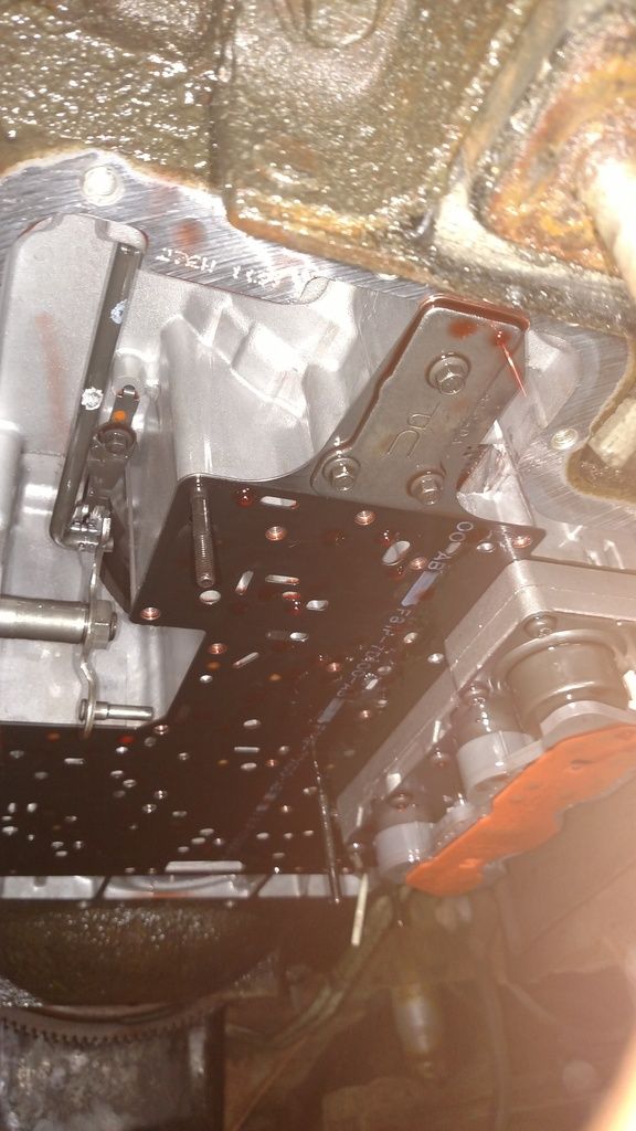

Ok Mark, or anyone else, I am in need of some definite help.
First off is do I need to take off the electrical valve control and remove the metal valve gasket? I don't 3 bolts other than 3 that hold some block off plate. Plus that metal valve gasket has 7 or so ***** on top of it that will probably fall out and I need to know where those would go.
Here is a picture of where I stopped for now
My next problem is the first valve body I took off was bolted on the bigger one. When I took it off I didn't know there was 4 ***** sandwiched in between them. The two I'm pointing at I'm pretty sure are in the correct locations. The two at the top I don't know. One is a tan colored and the other is a dark blue or black and smaller. Where do those go? Attached is a picture
Thanks for any help anyone.

update
I pulled the valve bodies, be careful of the check ***** between valve bodies. I was able to find pictures of where they go by doing searches. Powerstroke army has a really good thread filled with pictures.
got to the 3 pressure feed bolts. One was tight, the other two I might have gotten an 1/8 of a turn.
I ohmed the solenoid pack since it was out and that checked out in range for everything.
I put it all back together and new mercon V.
