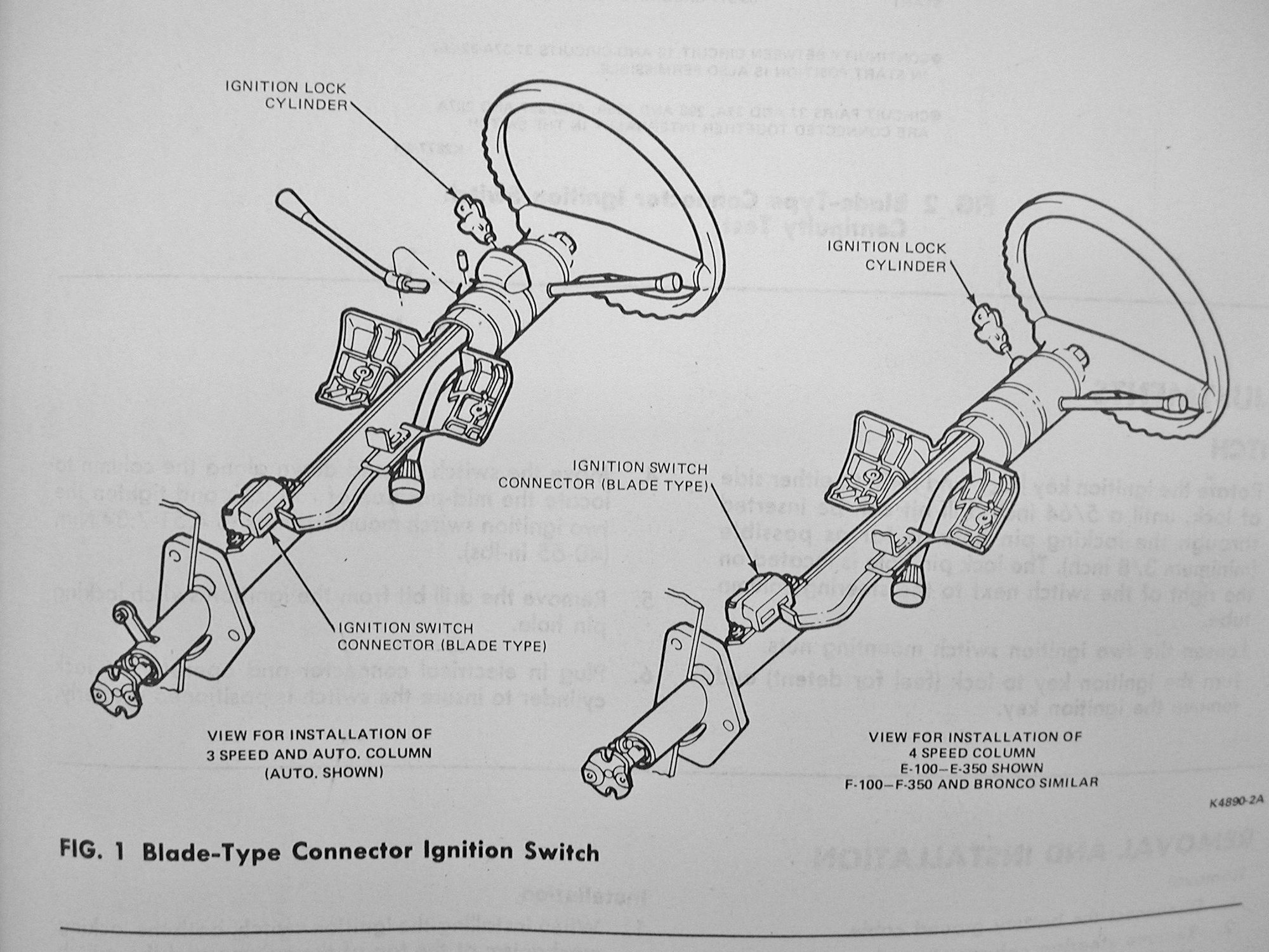

I am having this problem also, but cant seem to locate where you would adjust the ignition underneath the steering column. Does anyone have a picture or could explain it in detail more? New to the bullnose trucks so I am learning .

See if this helps:
