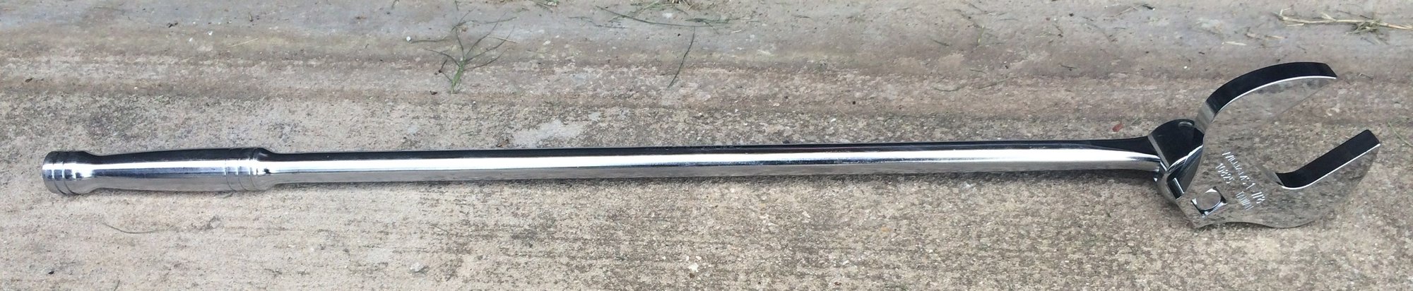

I went super hi-tech with a 1 7/8" crowfoot and a breaker bar, with a 24" 3/8" extension into the water pump:
