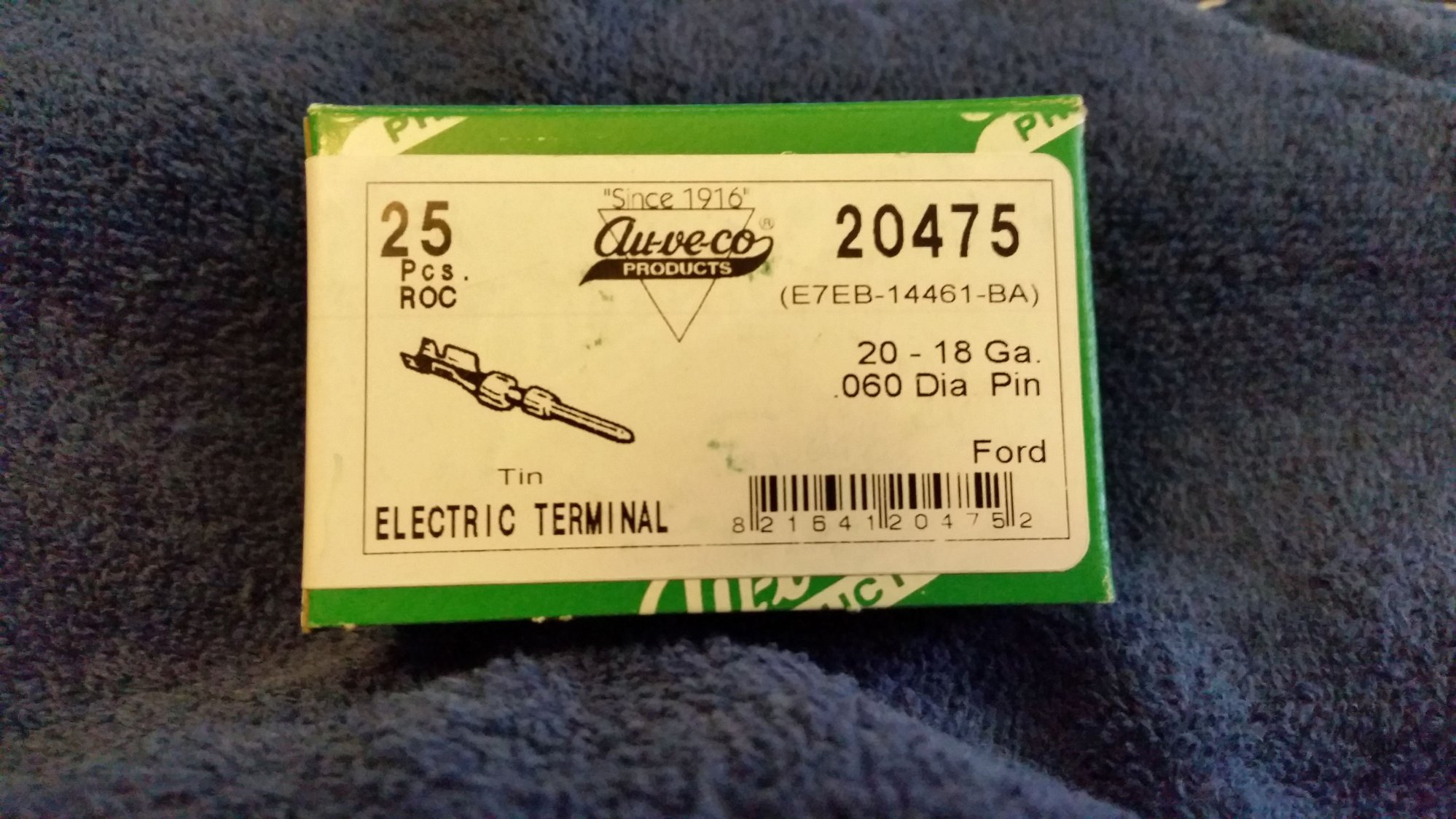

I got the terminals, today.
A box of 25 ea.
Code Item Qty Price Grand Total
A20475 Ford Wedgelock Pin Type Terminals 20-18 Gauge .060" Pin Diameter
1 $7.69 $7.69
Subtotal: $7.69
Tax: $0.00
Shipping Cost: $4.54
Grand Total: $12.23

Persistence pays off again!

I'm starting to use Dogpile, for my search engine again and finding more results than I got with Google. The terminals are wedgelock, .060 diameter, open barrell type.
