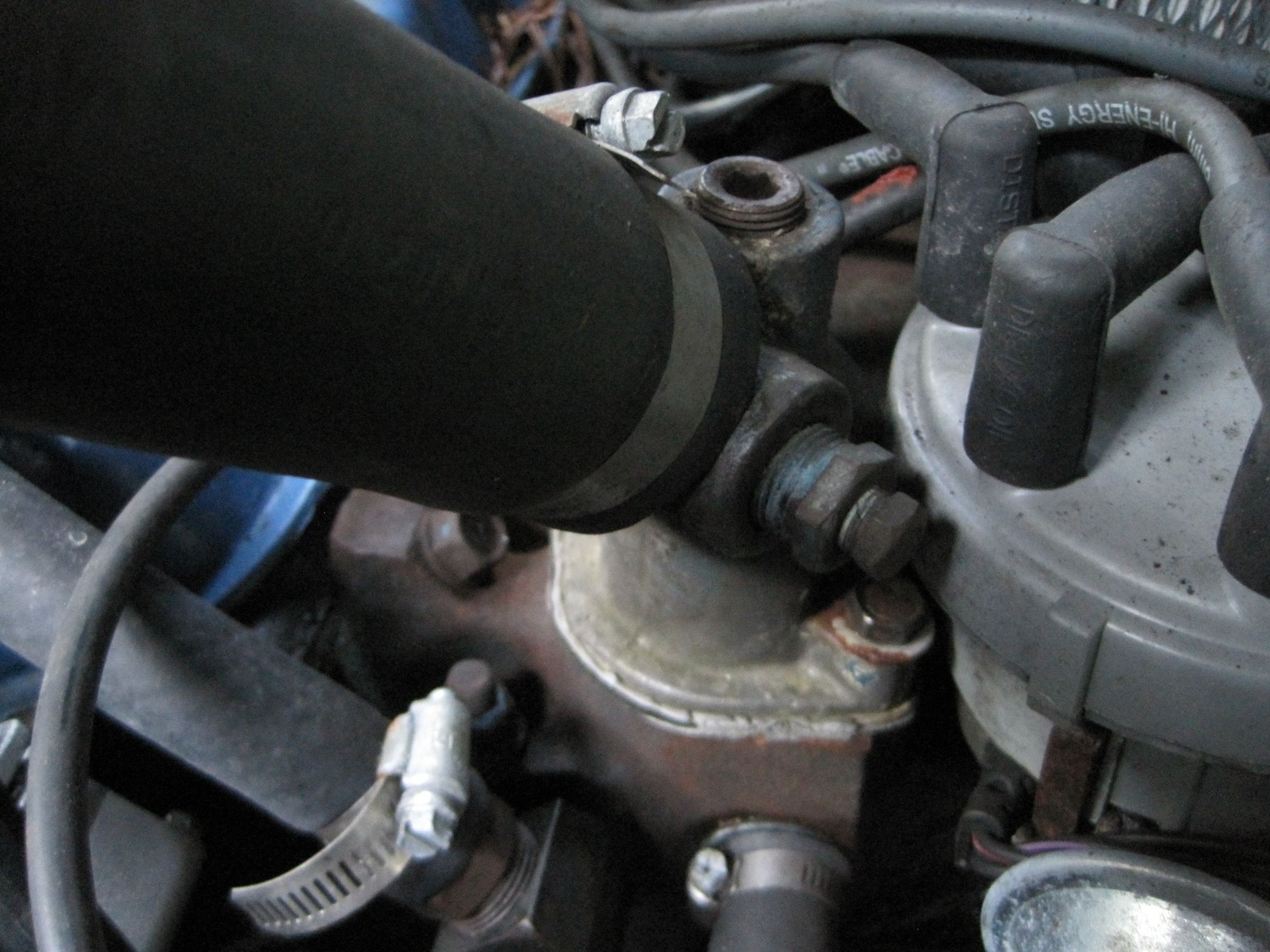

It certainly is possible to run without whatever it is they support. Here's pictures from same area on my 460.

Truck changed hands a couple of times before I bought it, so I'm not positive on all the details (could be mild rebuild). It has stock heads and intake with a Holley dual fuel carb. There are vac lines for advance, transmission and brake booster. That's it.
