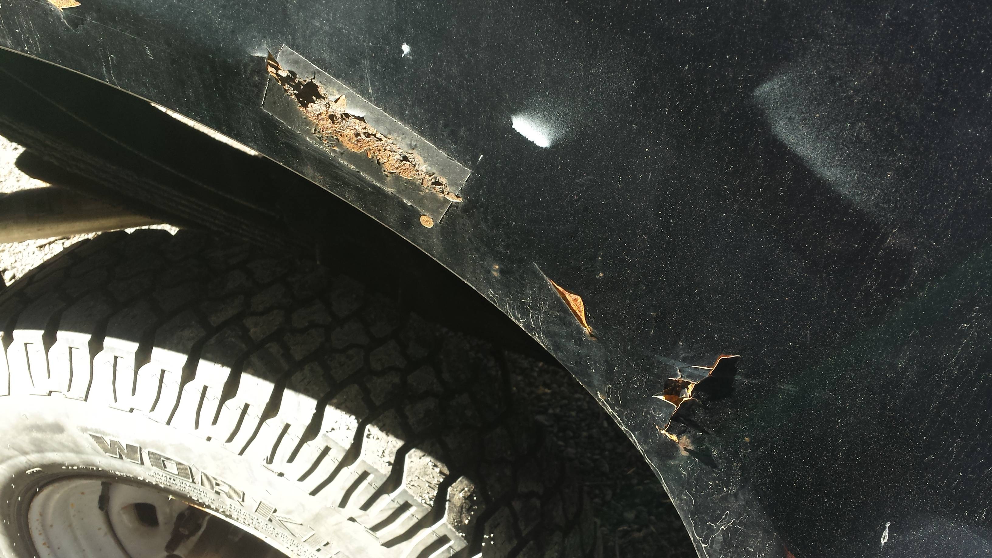

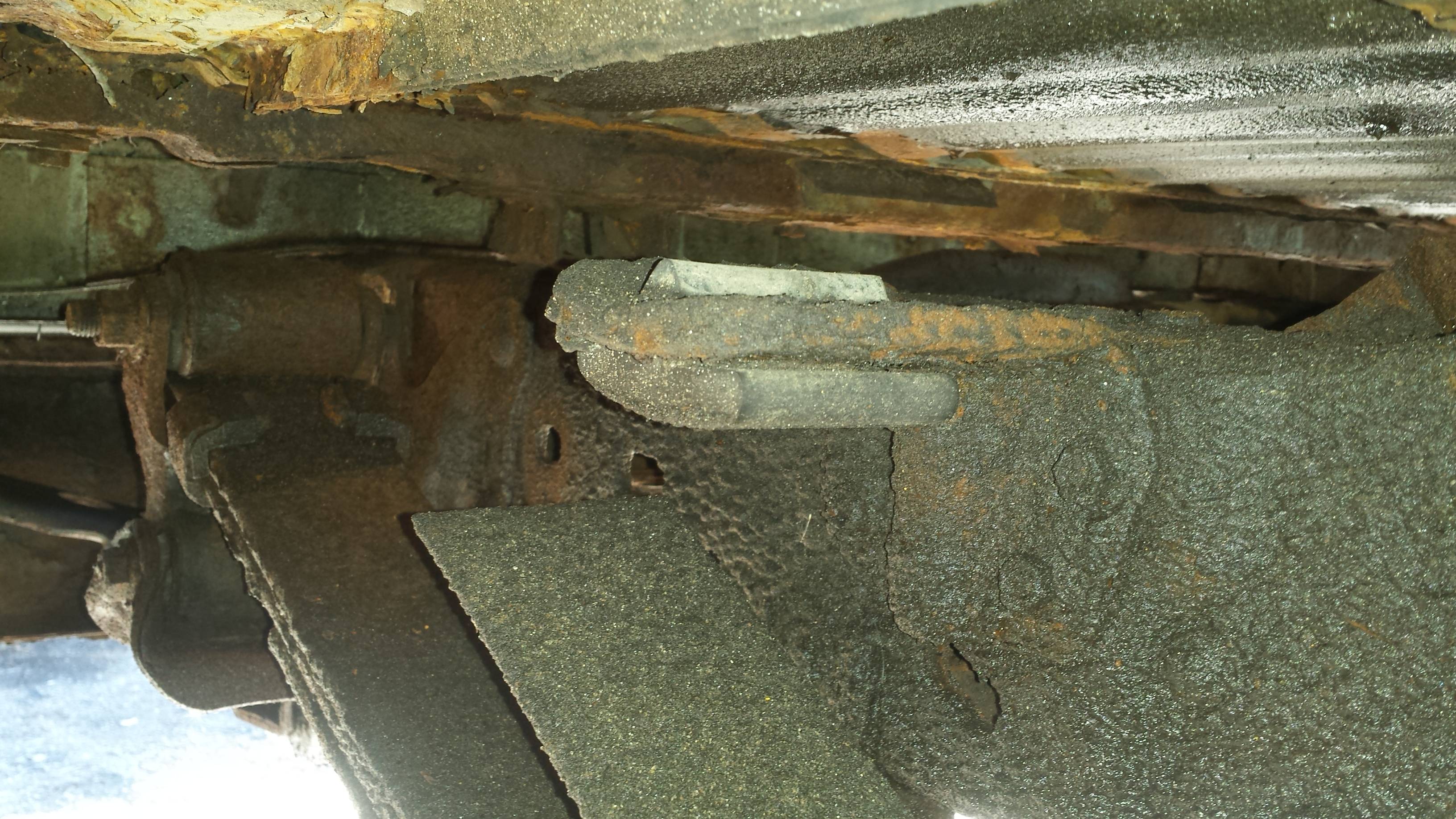

The whole bed is too far gone, I think. I don't do body work so the fender or bed side would cost a bit to get replaced (and being in NY - where could I even find one not rusty) ... the bed supports are gone and there's a hole in the floor of the bed.
If I could find a bed side, I could probably hoist it up and weld on new bed supports ... potentially. The hold could easily be fixed with a piece of scrap metal.
Attachment 290270
Attachment 290271

annnnnnnd the fender:
Attachment 290272

Yeah I would get a new box for sure!!

This is NY. Unfortunately, everything else is just as bad. With only 58000 .... kind of want to keep it around as long as possible haha. Or just make and weld in new supports ,deal with the rotted wheel well and patch the floor.
The frame might break if I try to tow something, though.

If you Get a old style bed then try to get a 2010 bed or close to that then no matter where you get it, remove the foam at the rear of the wheel well on both sides and then Rhino line the hek out of it underneath, bed supports and all!! It is a waste of time and money to do patch panels on these beds as when you fix one spot then another pops up.
