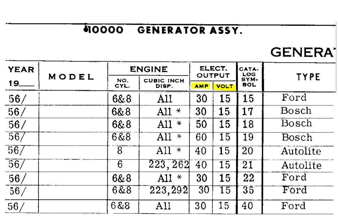

Looking through the Ford Truck Manual there were 4 different amperages offered.
Are they Interchanagable?
Has anyone converted a later 56-64 12v generator to fit?

Ok, found a generator. It is a FoMoCo 51296. Didn't find any info using google search. Any idea from this # what amp rating it is?

Might be easiest to have it tested to determine max output. Don't forget the regulator needs to match current rating.

Anything more than 30 ampere was kind of a rarity was it not? As in heavy duty service for law enforcement or ambulance or whatnot. And as mentioned it's the regulator that counts.

In 6v, yes, 40 amp was the HD model, but in 12v it was not uncommon.

Good tip to use the 6v, case. I have the 12 v generator mounted to get the setup done. The 30 amp generator will carry my basic needs + halogen headlights. Since this build does not have any accessories my draw won't exceed the capacity. Doing the math 80 watt lights will draw a bit less than 7a each.
