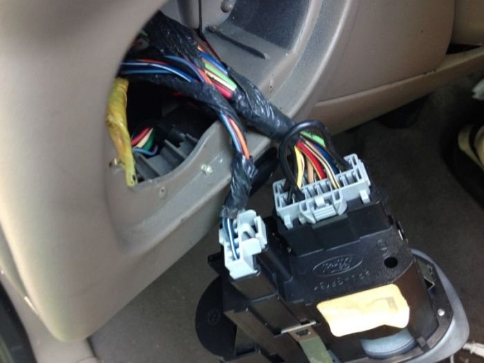

I had initially just jumped the #5 and #12 wires so they were always on.
I did not like not being able to turn the fogs off while my headlights were on so I filed the switch (but only on the Auto side, did not do it on the parking light setting since I never take my lights off of Auto).

My only question is what does splicing wires 2 and 12 do? I dont have the auto feature on mine. kinda glad cuz im not really a fan. I just wanna be able to turn my fog lights on and off with just the parking lights on. lol
Old May 2, 2015 | 04:35 PM
blupupher's Avatar
blupupher
Joined: Apr 2013
Posts: 354
From: Katy, Republic of Texas
Not sure what the #2 (fog output I believe) to #12 does (I saw it in the write up), but when you jump #5 to #12 it powers the fog lights (#5) from the parking lights (#12).
The pic is how I did it initially (#5 to #7) but the fogs stayed on any time the the headlights switch was in the auto position (even if the ignition was off), so I moved the wires to #5 and #12.
Since I did my HID retrofit, I just pulled the jumper off, the fogs are pretty much worthless now (kind of were before too).
