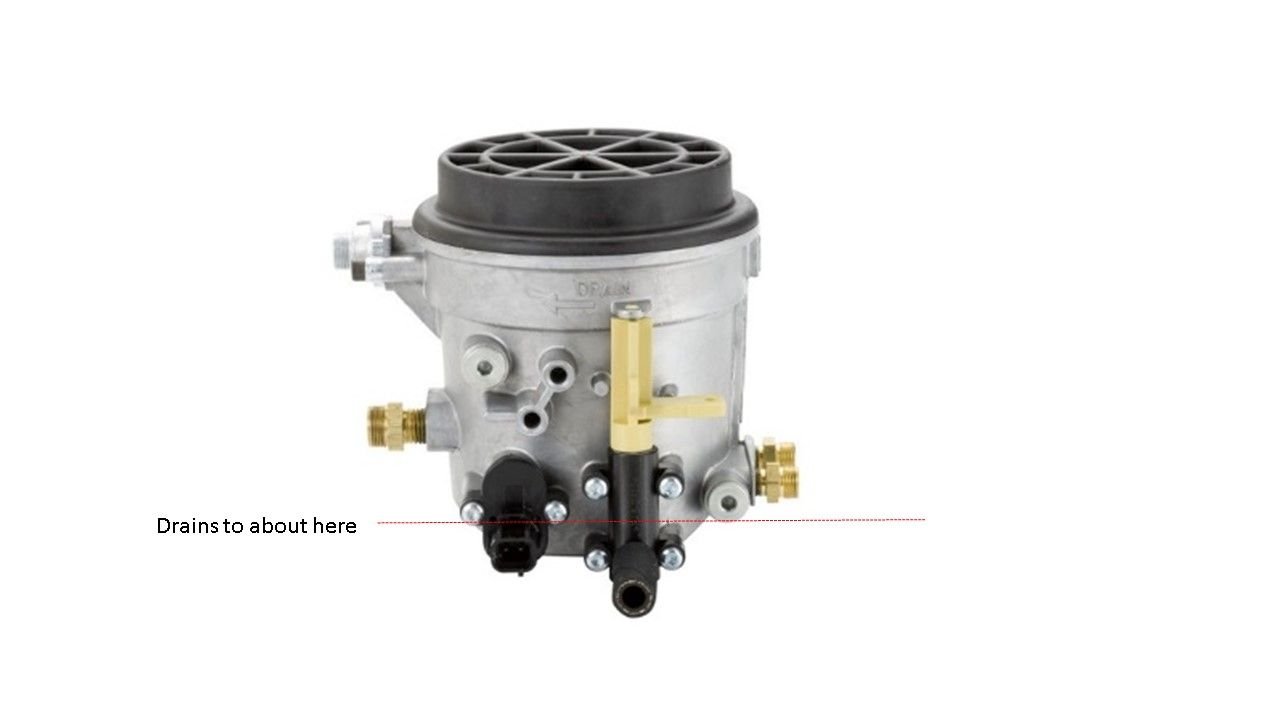

So my drain valve does not work....I only get a few drips. Is the valve itself the common culprit or the stainless line getting clogged?
Can the filter lid be removed...is the bowl under pressure? I'd like to get the bowl emptied so I can replace the drain valve as well as install my gauge sending unit. I don't have any leaks so wasn't thinking of doing a complete R&R.

The pressure may have already drained off to somewhere else.

Somebody please correct me if my memory sucks, but the valve should drain the whole bowl. Either your valve is not working, or your bowl is draining to someplace you don't want it to.
My info needs to be verified - I might be thinking of when I had the cap off.

My valve is not working correctly, and it leaks in the valley some when opened. My bowl does NOT drain....that is the root of my problem. I was just curious if the lid could be removed without draining, and I learned that it can.

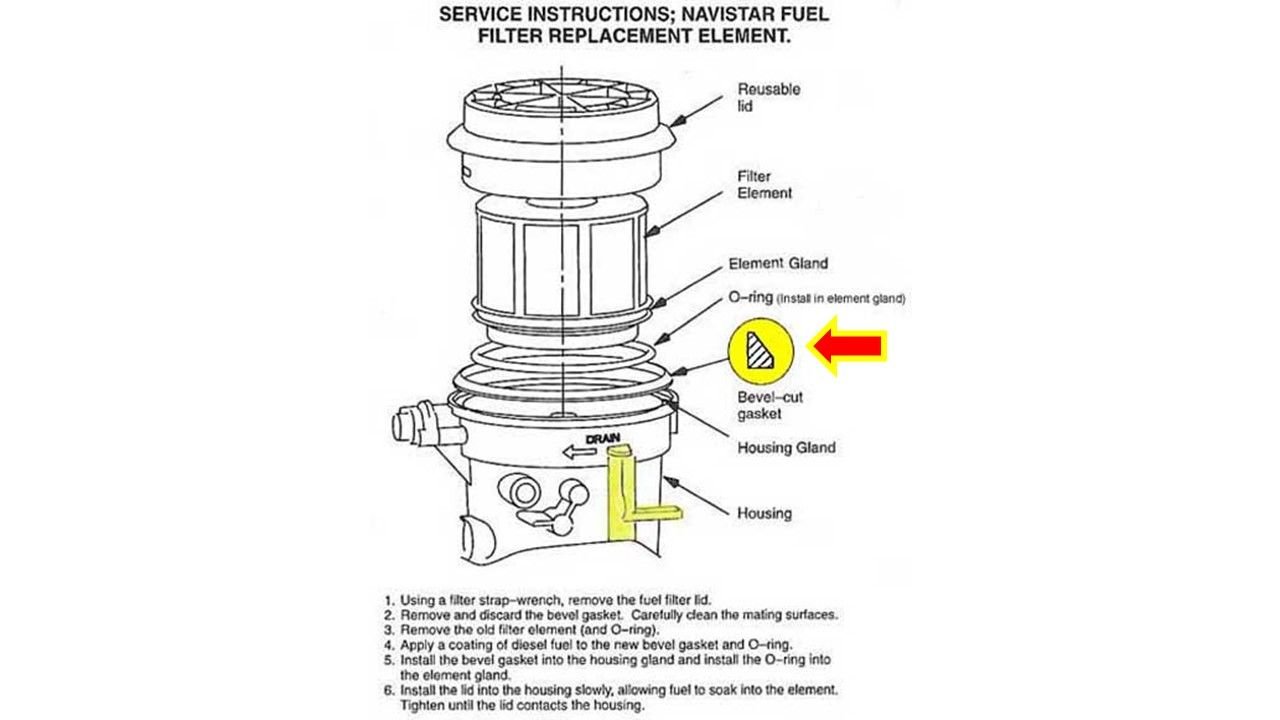

Perhaps the O-Ring is inverted? There are two which need to be installed. One on the Filter, the other on the housing.
** You shouldn't have to tighten it "too tight", maybe 20 Ft.Lb. as the O-Ring compresses to make the seal. You could also have some trash / corrosion where the O-Ring meets the housing. Maybe a good time to pull it and reseal it....
The drain valve passageway is probably clogged with trash.

My drain never worked either. Never found out why either. Never tried it with the key on, if it's blocked that should do it.

The seal was put on correctly and I made sure the housing flange was clean. However I put the seal on dry, did not coat with diesel....could that cause the seepage I am seeing?

That could well be the reason as the gasket can drag and be thicker in one area than another.
