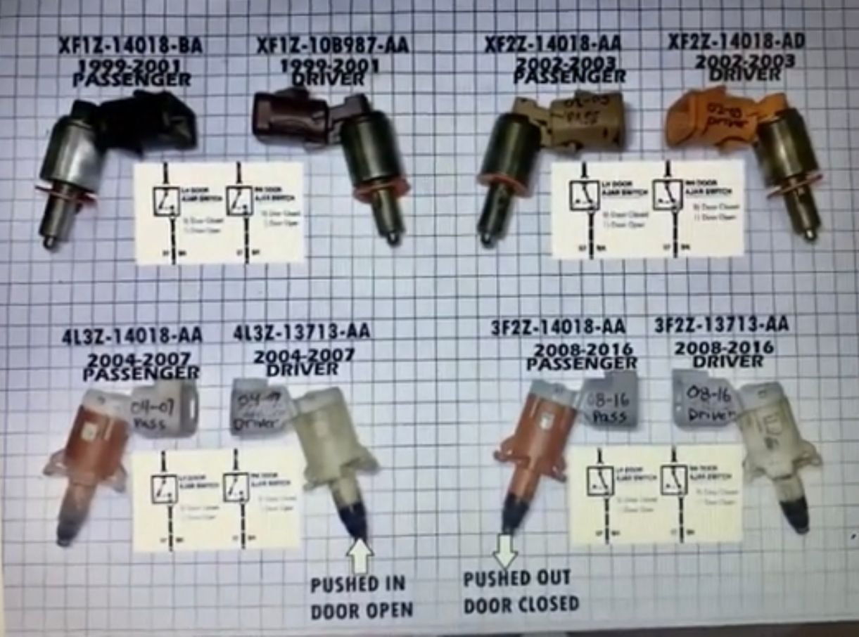

Here are the part numbers for superdutys and Excursions. The rear hatch/liftgate has one on each side so you can use the driver for driver side and passenger for passenger side latch.
Thanks goes to Mr. Zachary Macfarlane the Excursion and Superduty interior swap YouTube guru.
