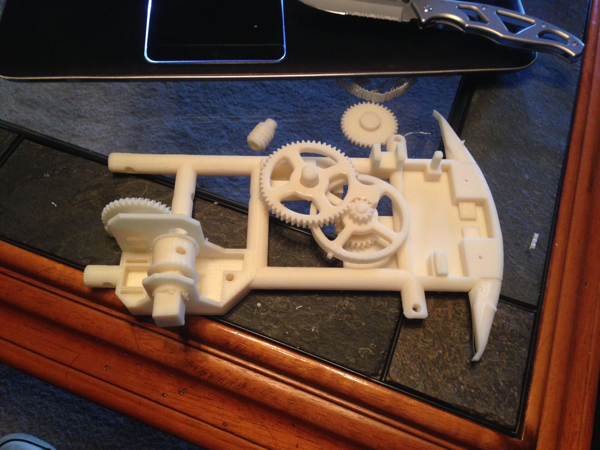

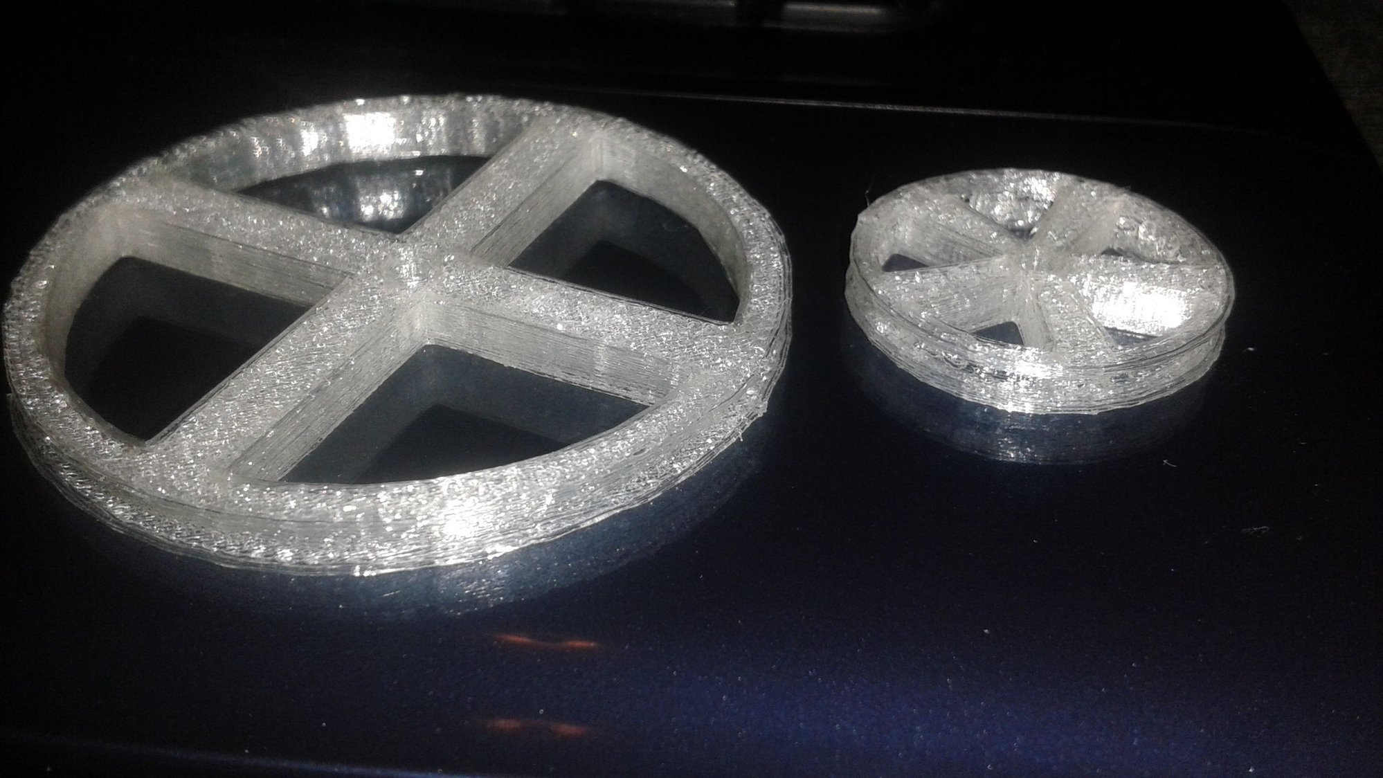

My experience with Makerbot and PLA was not very good. I am in my last semester of my undergrad for Mech Eng and we had to design a car completely made on makerbot. The PLA material was used on a Makerbot Replicator 5th Generation. The quality is OK but it is nothing up to what I would wanna put on my truck. That being said I also used a Makerbot Replicator 2X loaded with ABS and those parts are definitely production quality.
PLA on Makerbot 5th Gen
ABS from Makerbot 2X

Japrine - That's a huge difference! The magazine I referenced had the Replicator 2 as its #2 unit with a score of 37 vs #1's score of 39. And the 5th Gen came in, predictably, 5th with a score of 34. So, is the main difference in the PLA vs ABS? Is PLA short for Playdoh?

HAHAHAH yes the PLA may as well be play-doh, it looks exactly like hot glue when you see it extruding. I would imagine that the ABS on the 5th gen would do better but we didn't get to try it.
There are other differences though that are much better with the Replicator 2X. It is enclosed on all sides of the machine and the platform is heated. I think these factors are huge for the quality. The 5th gen is completely open to the environment so the heat is completely lost to ambient. The platform is glass and is not heated during printing either. All in all the only advantages the 5th gen has is that the platform is a bit bigger and you can plug in a usb drive, the 2X needs an SD card

Well, you've confirmedwhat I've read - the only way to get reasonable results is with a heated glass build platform and in a controlled environment. Fortunately some of the better printers are coming that way out of the box.
