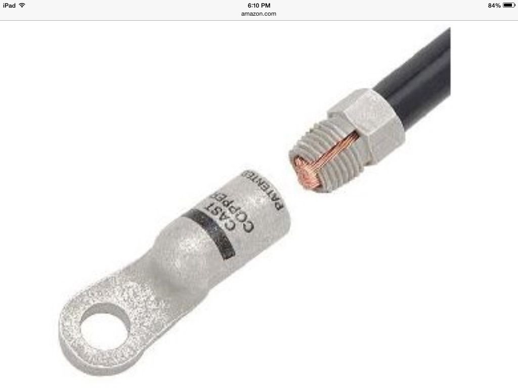

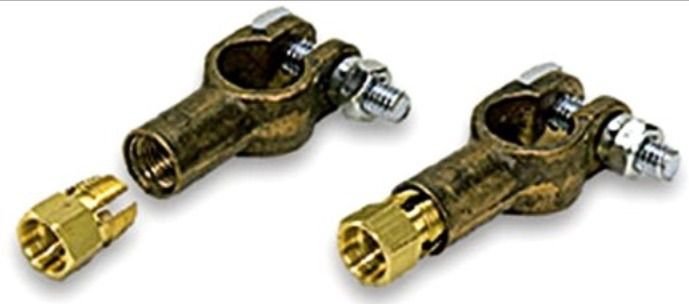

I've built a number of cables for our racecars, but I have the special lug compression crimper. I know there are some out there that have a threaded collar that threads onto the cable end, crimping the cable in place. I'll see if I can find the link to those.

Here you go.. I've seen these used alot and if I did not have the crimper, I would be using them or have them done at one of the places I mentioned..
Amazon.com: Moroso 74175 Battery Cable Terminal: Automotive Amazon.com: Moroso 74175 Battery Cable Terminal: Automotive
