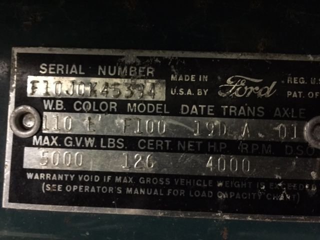

Can anyone tell me the date of manufacture of my truck and paint Color?
F10 = F100.
J = 223 1V I-6.
0 = 1960.
K = Kansas City MO Assembly Plant.
45394 = 1960 Numerical Sequence of Assembly.
110" Wheelbase.
L = Dark Green.
F100 2WD, 5,000 lbs. GVWR
19D = Assembled April (D) 19, 1960.
A = Ford 3 Speed Manual Transmission.
01 = Ford 9" Rear Axle / 3.70-1 / No Limited Slip / 3,300 lbs. Rear Axle Capacity.
5,000 lbs. Gross Vehicle Weight Rating.

1960
Thanks thats interesting, Do you think the grille is original?
No, it cannot be, because it's from a 1958 or 1959.
It probably swapped in because the two piece 1960 original was damaged and a previous owner couldn't find a replacement.
