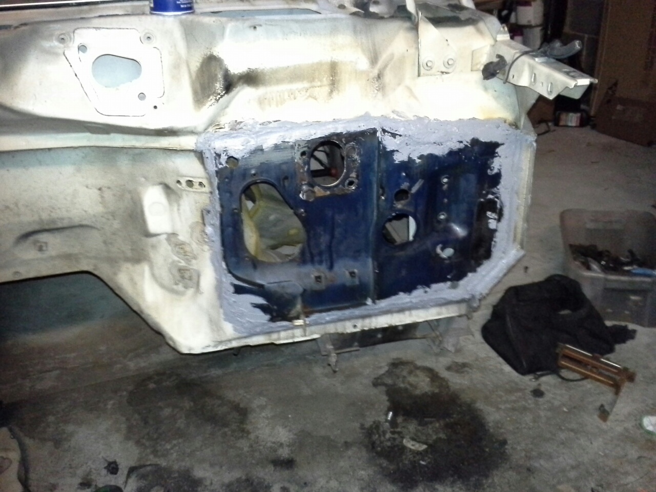

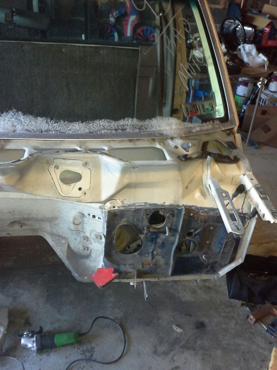

Pulled my baby out of the garage (2014 Mustang GT, with TrackPack and Recaro seats) and rolled the cab in to do the firewall. I cut the driveside out of both cabs, leaving the mounting area of the brake booster on the new cab. Bolted the old firewall up using the booster holes. And started welding. Welds are ugly but I trust them. Seam sealed the welds. Gonna lay some primer on the exterior tomorrow so I can put the Mustang away before it starts to rain or snow again. Outside temp was 17*F and the garage was about 35*F
