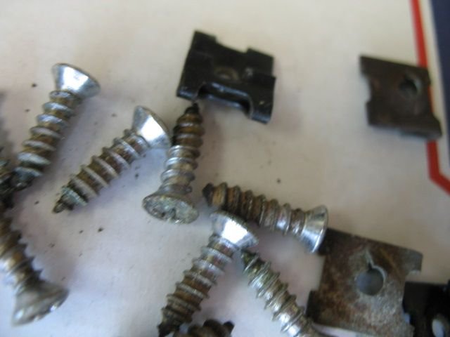

Shadow: The 8 oval head screws are chrome plated and about 5/8" long. They are actually #8 screws with a #6 head and will be hard to find except through an automotive fastener specialty house. The #6 head allows the head to sit flush in the "countersink" of the dash surround. A #8 will sit above the surface a little bit, if you care.
The four screws that retain the speedo cluster are slightly larger, #10 chrome plated round head Philips sheet metal screws about 3/8" long. If you have a fastener house nearby, stainless steel fasteners look nice if you polish the heads, and they won't tarnish. Photo attached so you can see. The chrome has lost its glow on these. Ditto, on the glass has no sealer. I would personally run an extremely thin bead of silicone between the glass and the metal, using a tiny orifice syringe, so there is no rattling. Mine was a little loose as factory.
