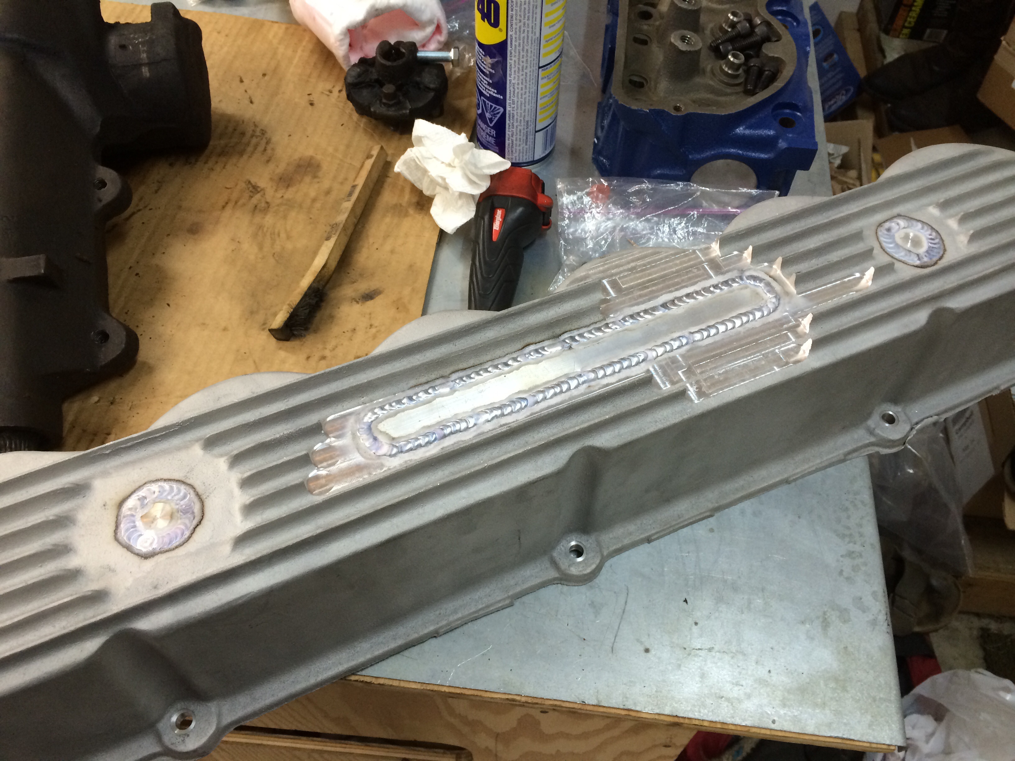

Ah... right. Obviously I neglected to update this thread.
I got that valve cover patched up.

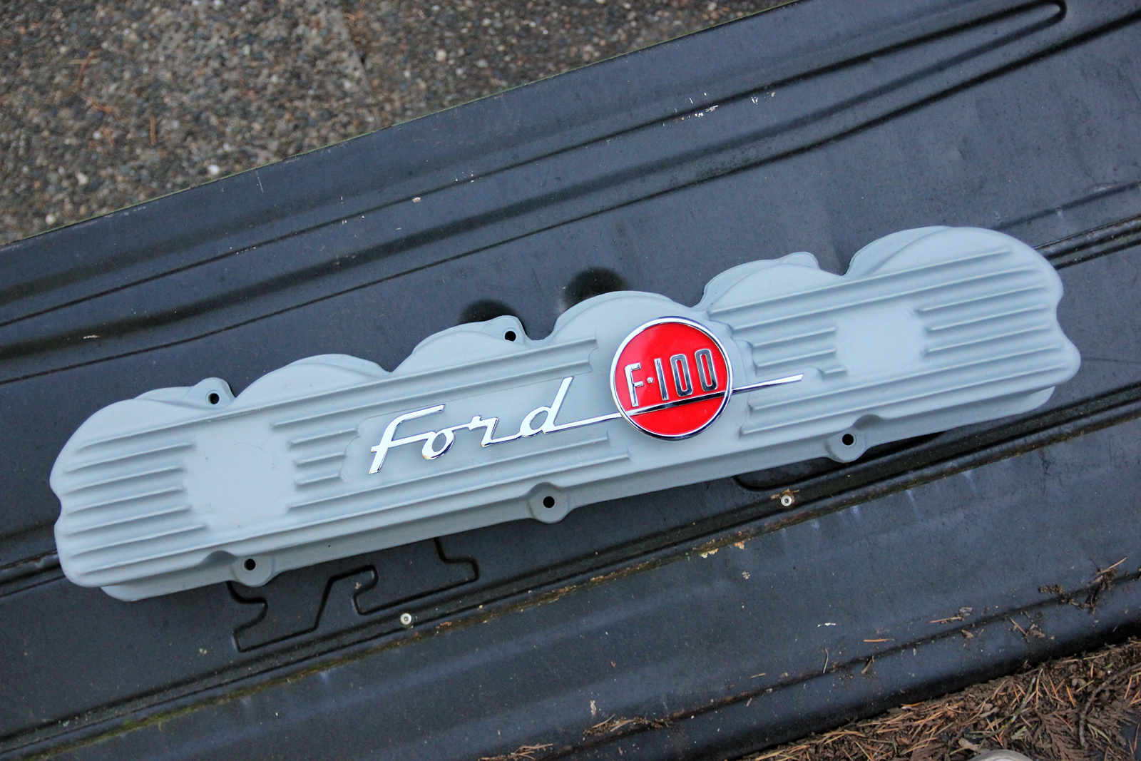

Here it is in primer with the badge.
Attachment 289060

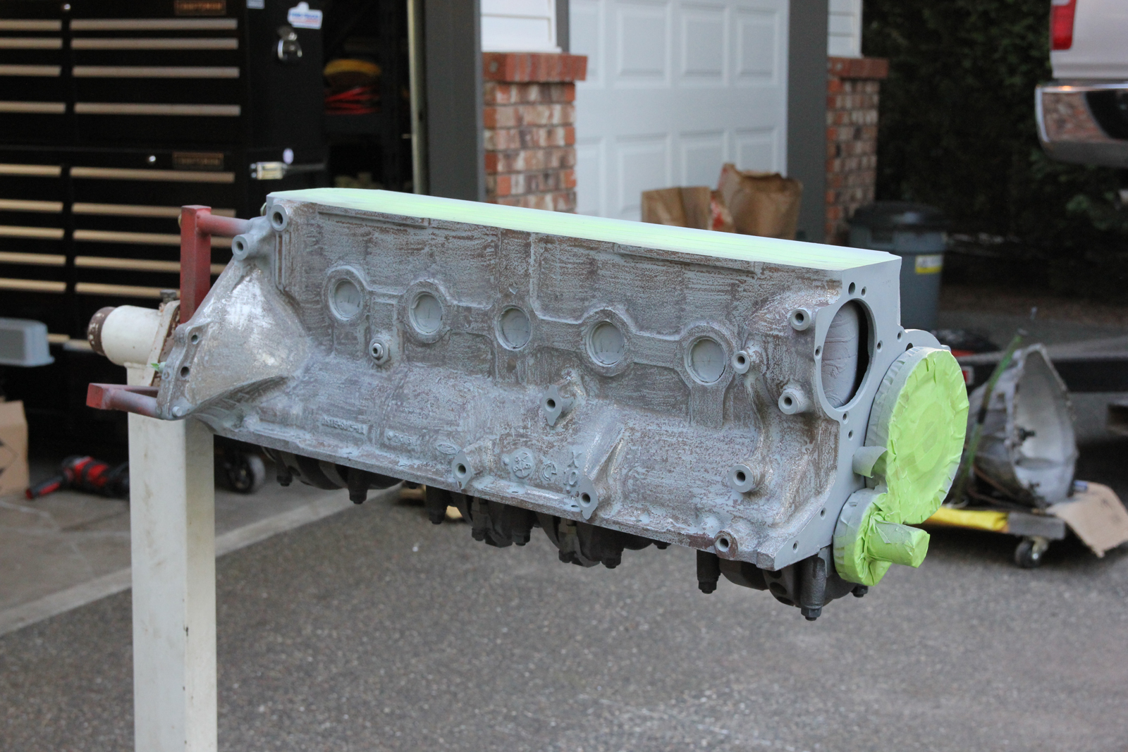

I primed the engine but it wasn't very smooth so I spent a few hours on it with the dremel.
Attachment 289061

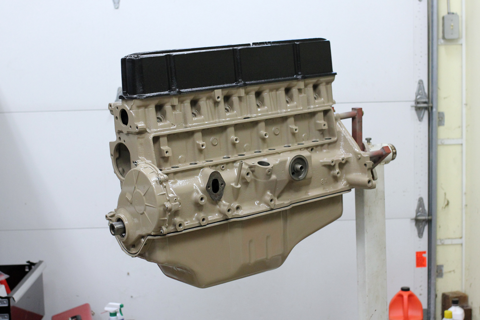

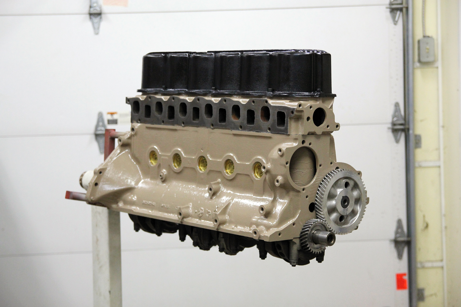

I actually didn't like the blue anymore so I painted it Cummins beige.
Attachment 289062
Attachment 289063
