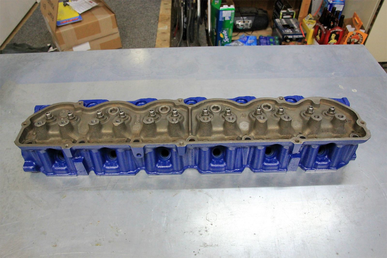

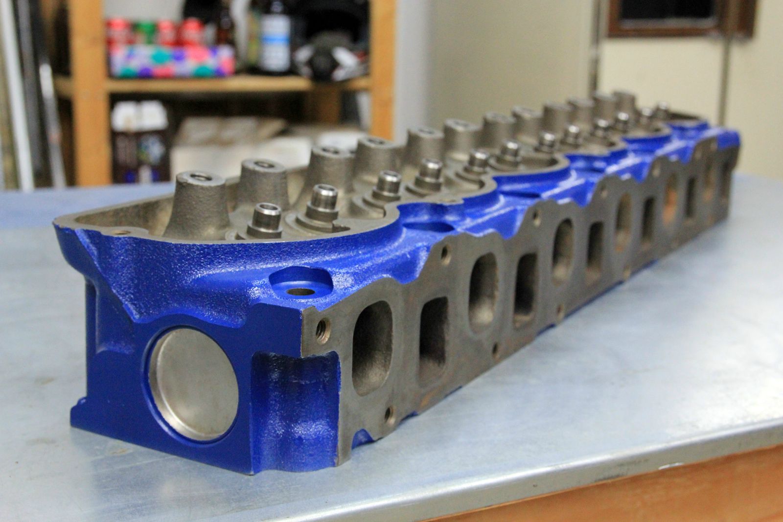

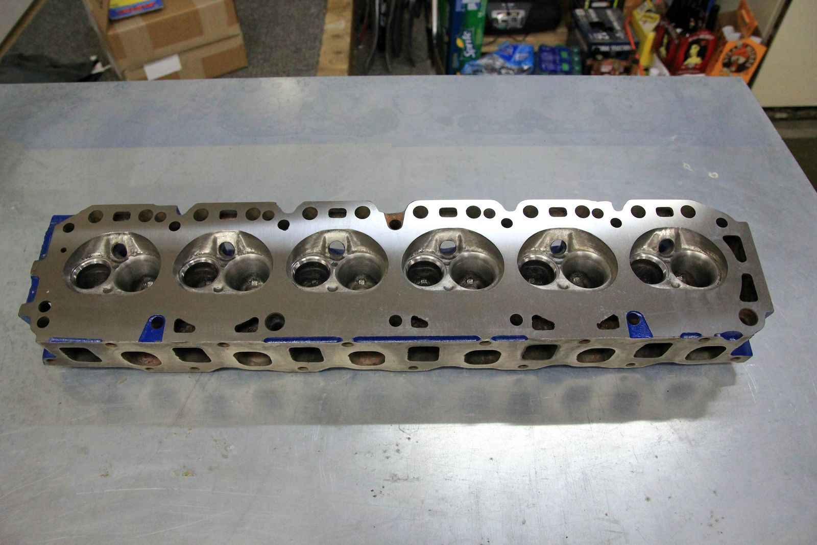

Painted the cylinder head.
Attachment 290708
Attachment 290709
Attachment 290710

Mtphammer
Joined: Jan 2014
Posts: 277
From: Fresno, California
Beautiful.

That seems a shade brighter then mine, and I love it!
Could you measure the freeze plug for me? I just remembered I needed to do that and the trucks not here with my right now. If I don't post this I'll forget aha
Old Feb 13, 2015 | 07:54 PM
  #70
trozei's Avatar
trozei
Joined: Nov 2012
Posts: 2,806
Likes: 8
From: Langley, BC
Two inches.

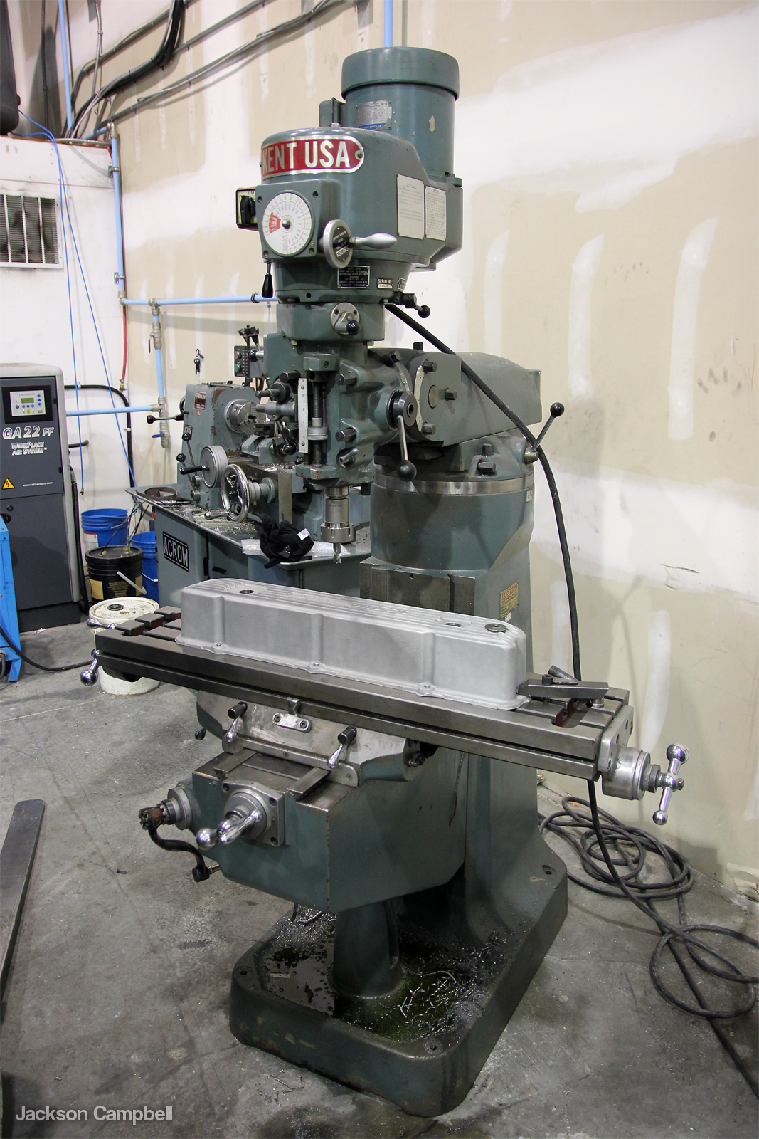

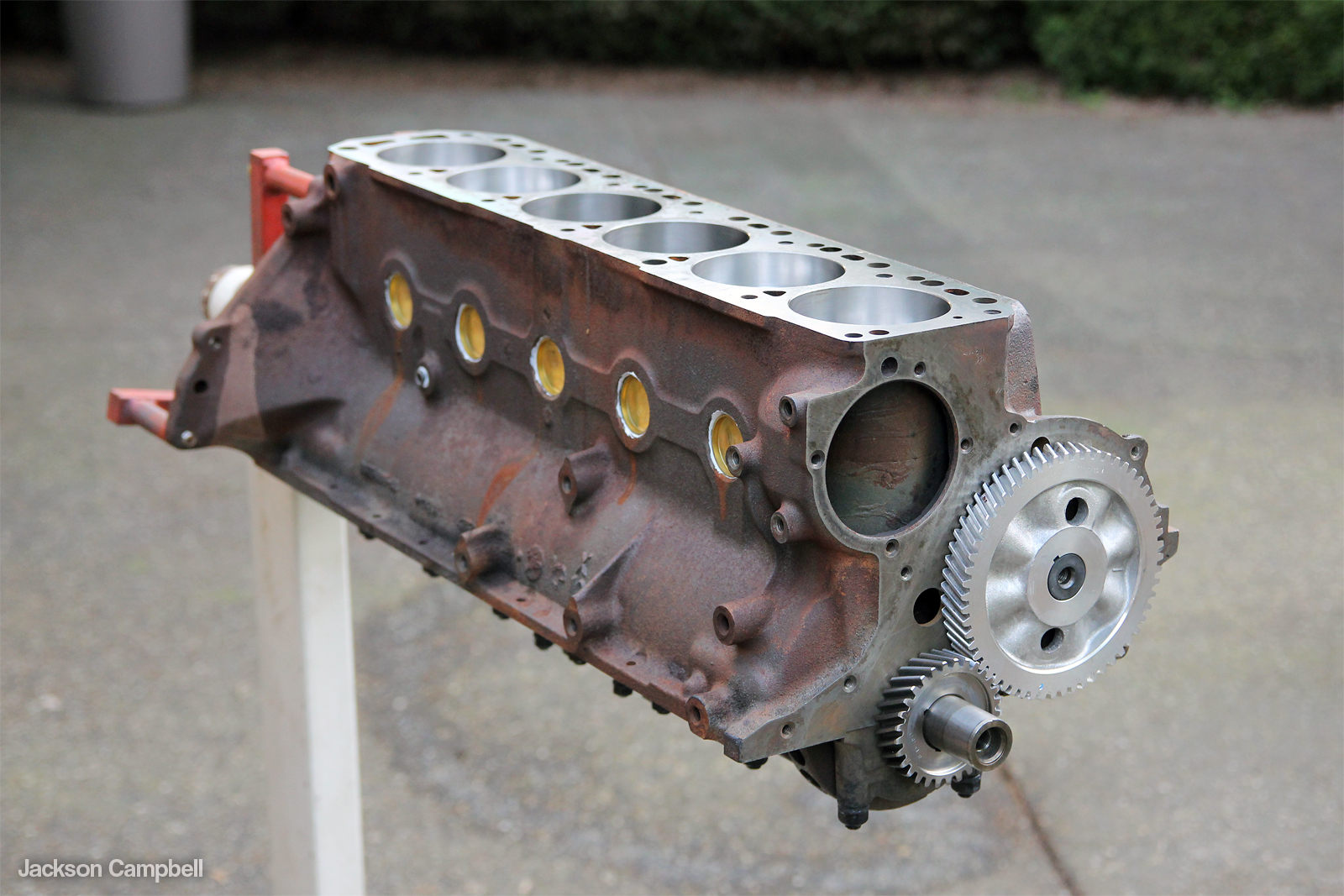

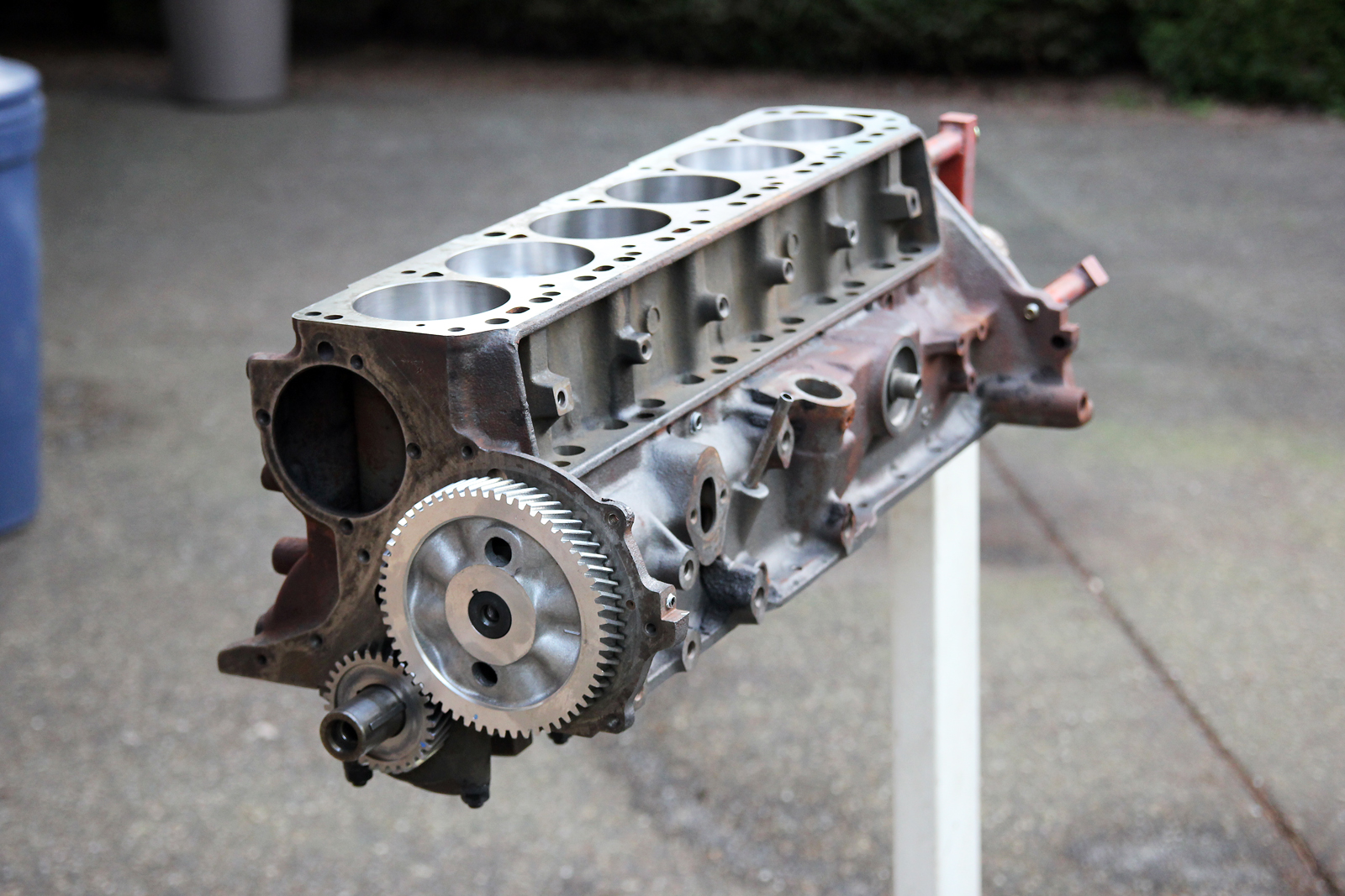

Machine work is done. Bottom end is built. Awaiting paint to show up. Had to special order the colour.
Attachment 290430
Attachment 290431

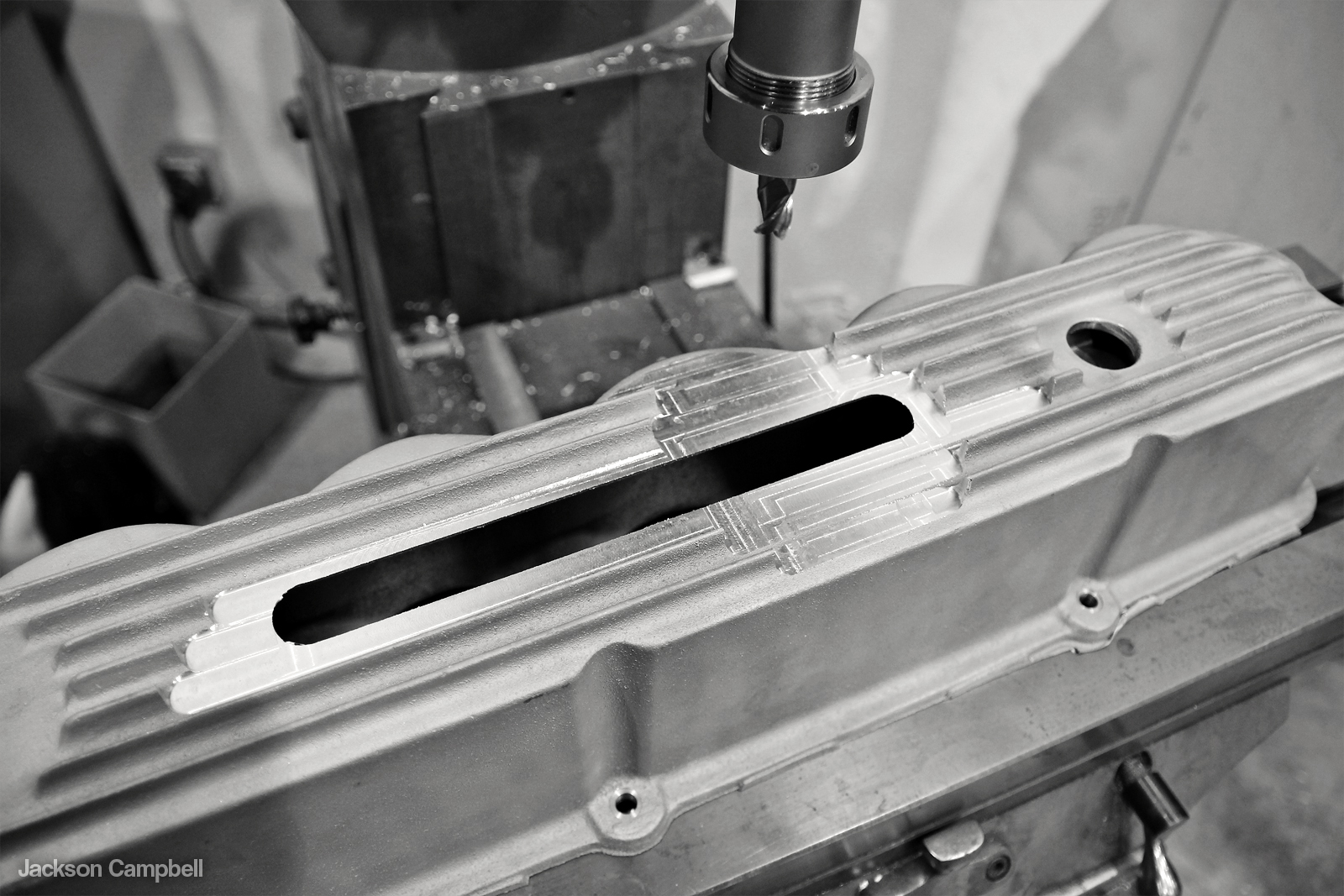

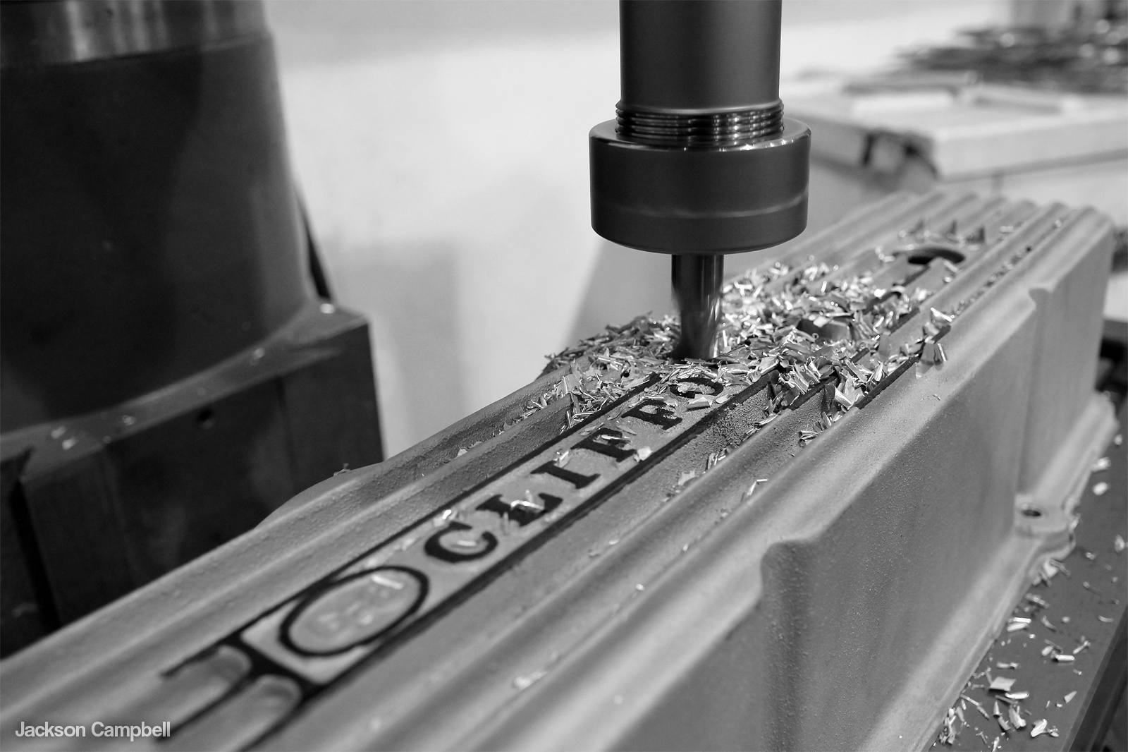

Chucked the valve cover on the mill. Faced off some of the fins. Found out the hard way that the casting is not as thick in the center so I'm going to have a patch tigged in.
Attachment 290432
Attachment 290433
Attachment 290434

Why did you face off the fins?
