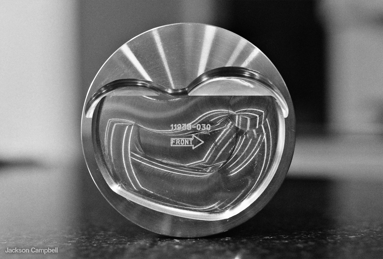

Got some long awaited goodies in today.
Attachment 291031

Specs? Manufacturer? or is it a secret?

Probe 11938-030.
385g each
20.1cc relief
4.030" bore
1.175" compression height
0.912" pin diameter

Originally Posted by trozei
Probe 11938-030.
385g each
20.1cc relief
4.030" bore
0.912" pin diameter
Thanks Trozei Are these custom or off the shelf?
Not custom but they are not stocked in many places because they are a low production item, so they typically need to be ordered and Probe will make a set.

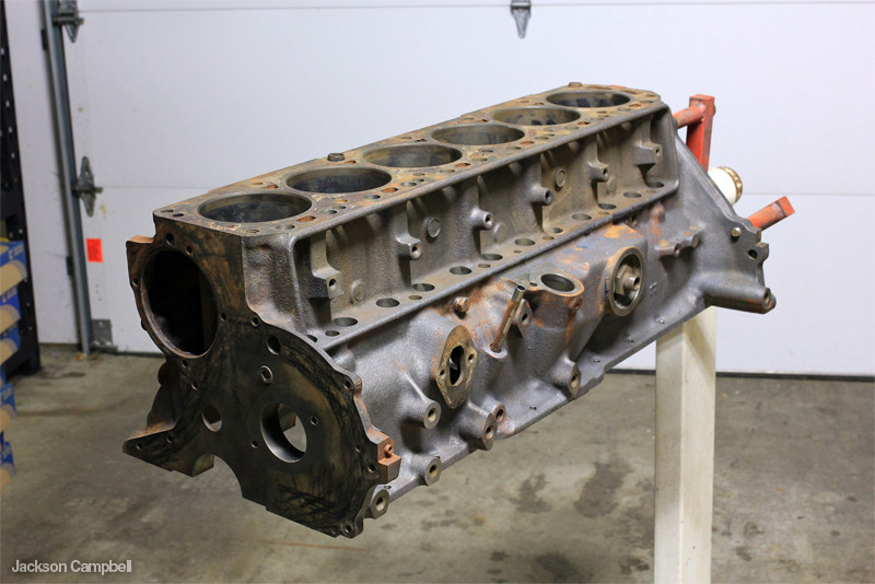

I got fed up with working the same hours that the machine shop was open, so I sent my dad down to go pick it up for me. It costed a whopping $30! Which was a happy surprise. The big name shop around town would charge $100. I completely forgot how grey cast iron is. I'm so used to the brownish colour. This is actually the first time my young eyes have seen a true as-cast grey.
Attachment 291023
