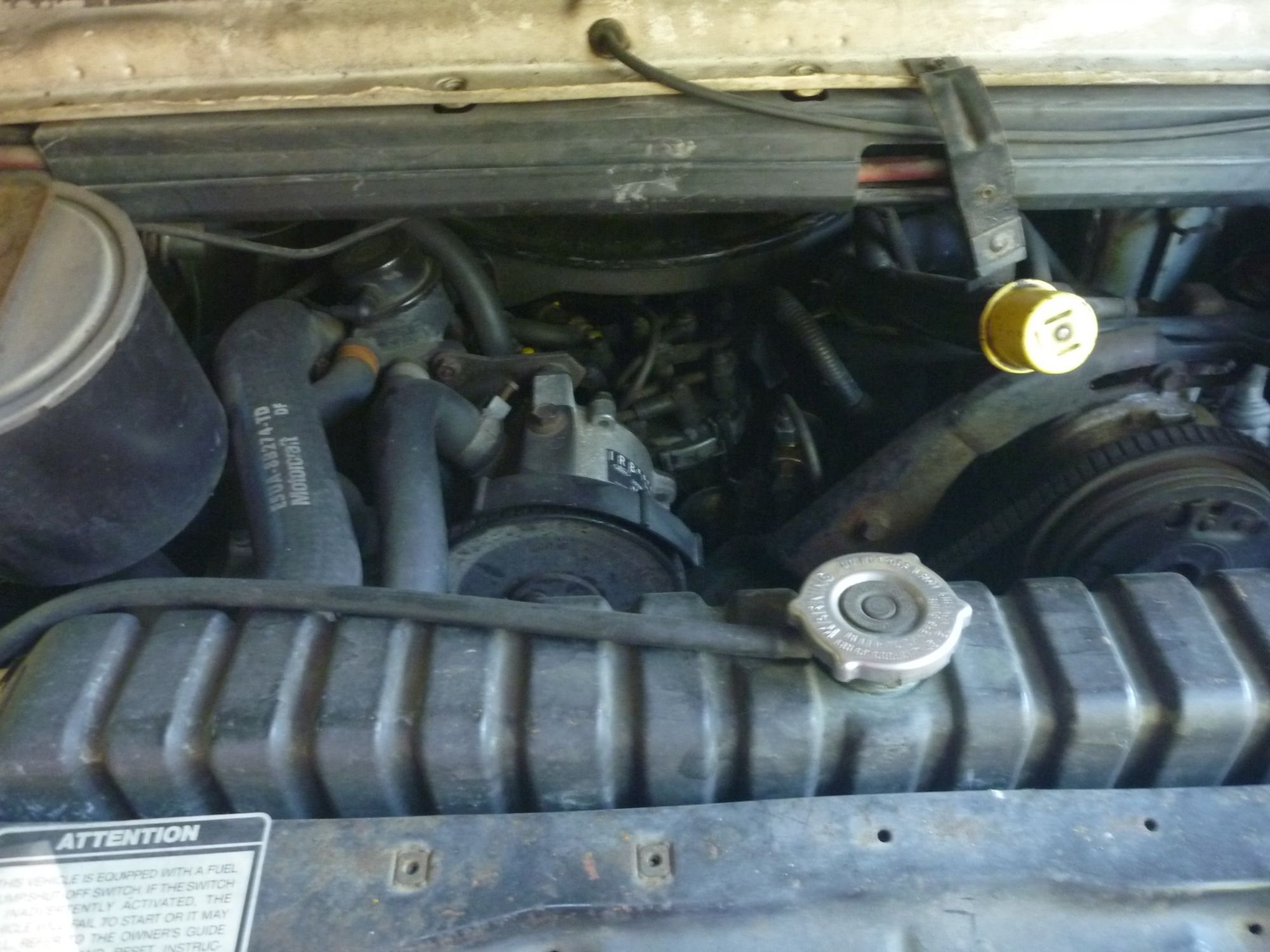

if you post a couple pics here of the engine and engine bay, somebody will be able to help.

My fatherinlaw and his friend have searched everywhere. No stickers. But I did take a photo of the engine a few days ago, so here it is...
