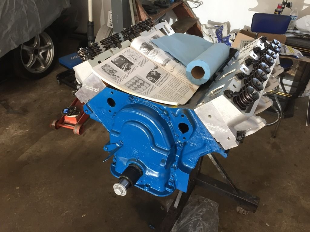

Originally Posted by Krewat
Wow, very nice truck
Well, this is a more accurate depiction at the moment. Hope to be following PA74F250 down the same path soon.
Old Apr 24, 2015 | 07:18 PM
  #54
PA74F250's Avatar
PA74F250
Joined: Jul 2010
Posts: 2,099
Likes: 8
From: York, Pa
You better get crackin I'm soon done lol.
