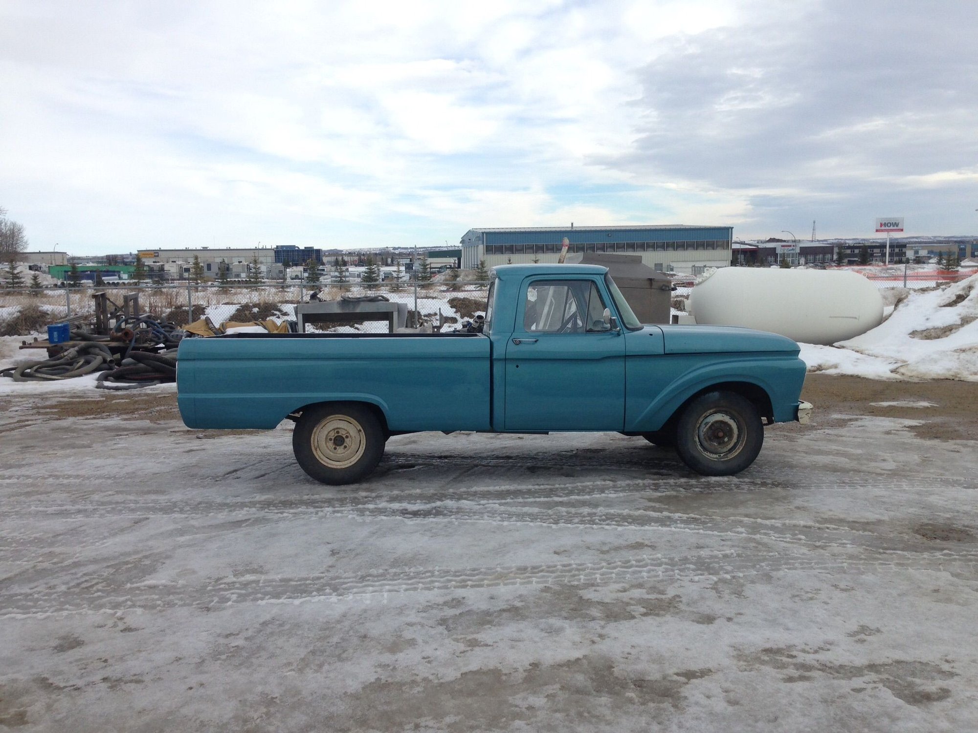

Originally Posted by 1963mercury
Are you sure this is a 1963? This Styleside bed wasn't available until 1964.
Old Feb 26, 2015 | 10:25 PM
1963mercury's Avatar
1963mercury
Joined: Jul 2014
Posts: 26
Yup, it is a 1963. I took 7 inches out of the front of a 1964' box and mated it to my 63' Mercury.
