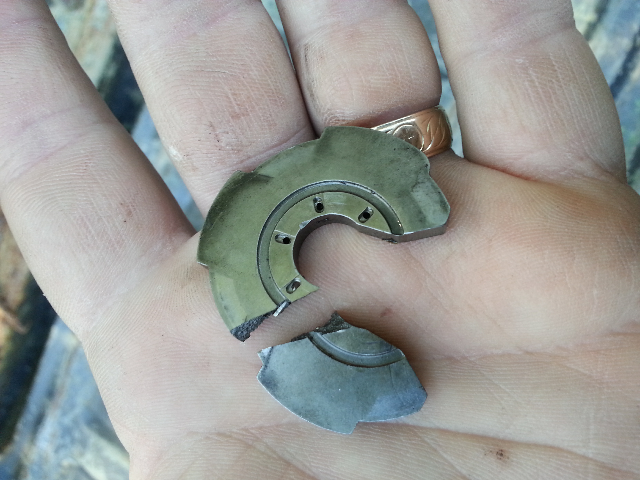

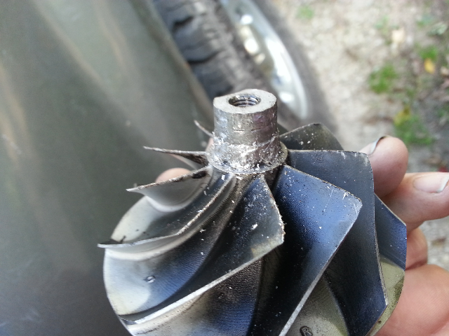

This is what I ended up with after tearing it apart.

cj: I have never torn a turbo apart before. What is that big cracked washer doohickey and where does it go?*

The horseshoe shaped doohickey is the thrust bearing. It's on the backside of the compressor cover. It has to take a heck of a shot to break that.

Originally Posted by cjgray1974
Attachment 107471
Attachment 107472
Oh boy! It's rebuild time!!!!
Looks like new compressor housing time too...

The housing didn't have any damage. The stripped nut on the compressor wheel is from how hard it came off. Not sure if that's what broke the thrust bearing too or what, but it just fell out when I got it apart.
