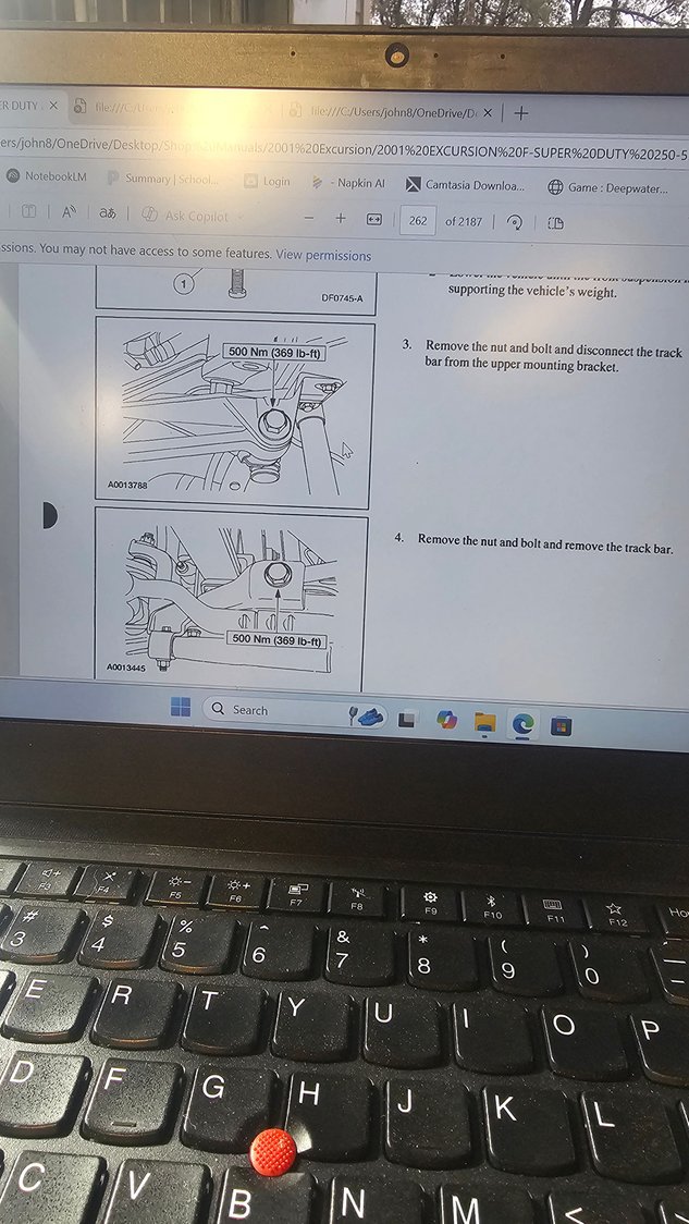

I've been reading threads on here trying to find the torque for the track bar bolts. My bracket is broken were the bracket bolts to the frame. So to weld this I will have to take the track bar loose most likely at the axle. Now my issue is My Haynes manual says 406 lb ft for upper track bar bolt and 189 lb ft for the bolt on axle. doesn't make sense to me since they are the same size bolt. So I get on here and I've seen 369 lb ft for both bolts and 406 lb ft for both bolts??????? So anyone know for sure?????

https://www.ford-trucks.com/forums/9...ml#post8222938
here is a pic and page were clay from riff raff shows 369 lb ft,
but ive seen the same pic with 406 lb ft.

ok, I belive the correct torque for track bar nuts ( upper to frame bracket and lower to axle bracket ) for 2000-2002 super dutys are for the majority of research are 369 lb ft.

Hi Folks,
I have the '99 F350 and it has the smaller track bar bolts. 389 ft lbs would be way too much. I dug out the Haynes manual and wanted to share. I like to find specs in print where possible, especially when the inter-webs have conflicting information. This may help the next guy or gal when they search.
129 for the '99 and 389 ft lbs for the 2000-2003. See attached pic.
I get a lot of help on FTE and wanted to help in a small way.

The original spec on the shop service manual for 2001 4wd was 369 foot pounds. It was revised to 406 by Ford recommendations to combat death wobble and loose steering
