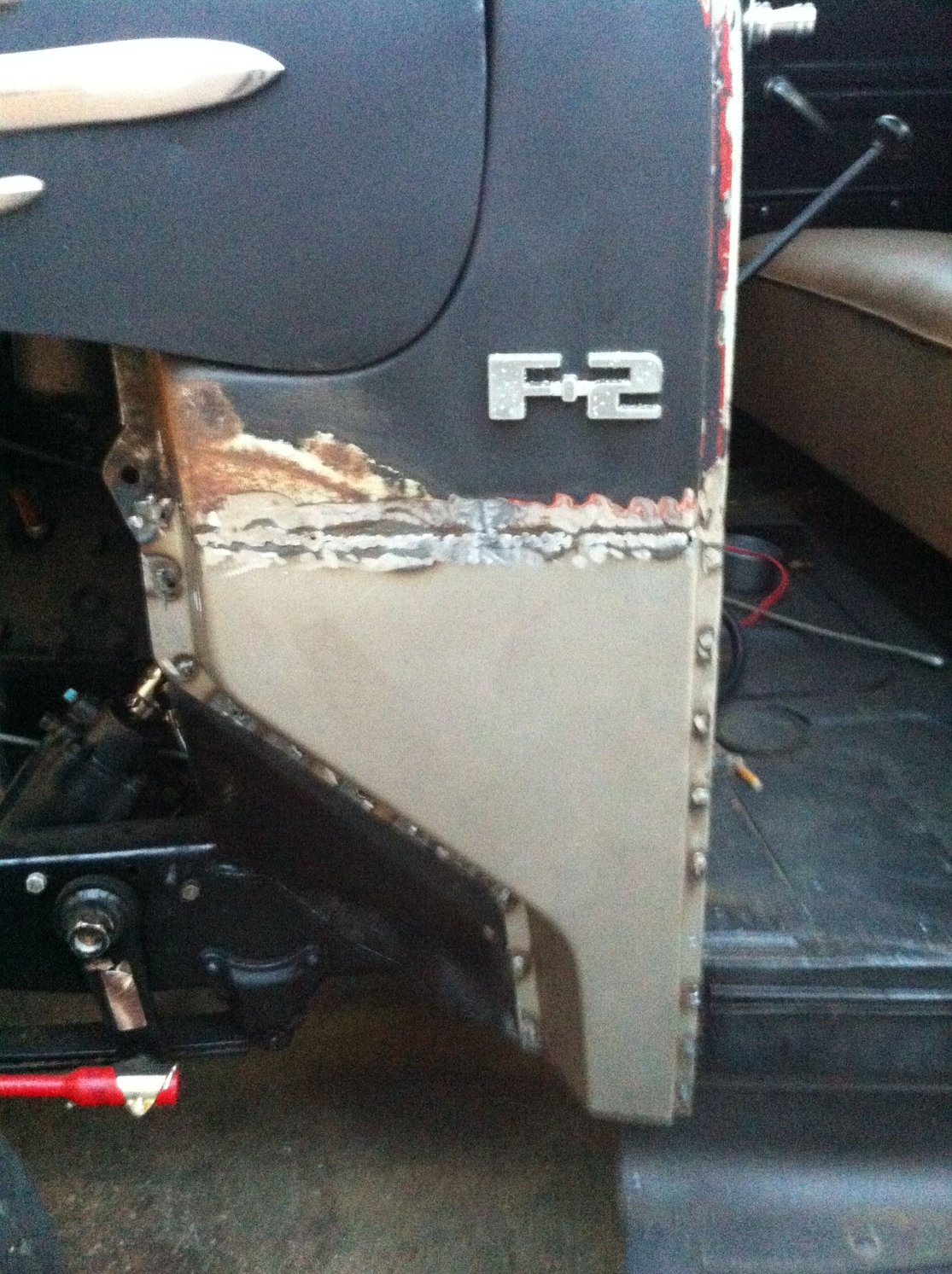

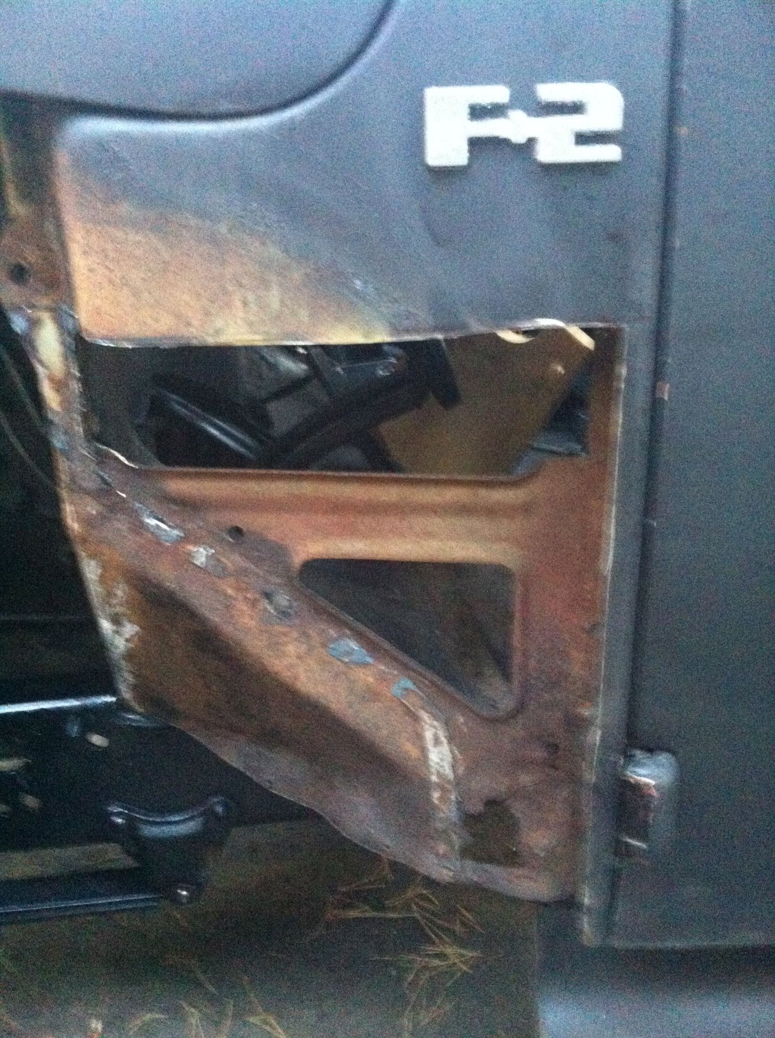

I don't know what truck you have or where you live (suggest adding that to your profile and signature through UserCP) but I replaced both of them on my 1950 F2. If you have a mig welder it isn't too bad. The hard part is fixing what you find underneath these panels. Also make sure that the panels that you get have good, crisp contours that match your truck before you start cutting them to fit. Some of the parts out there are made with sheet metal dies that have not been maintained properly.
Here is what I found on the driver's side. The passenger side was worse.
