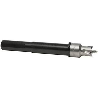

Buy yourself a spot weld cutter, there are several types. They will release the panel from the under lying parts. Clean the area to bare metal to see how far up the rust has eaten away the corner. There are 2 different sized patched you can buy for that area,,a 22 inch and a full length from the seam down, there is also a stiffener brace behind the cowl where the fender bolts to, if it's not too rusted at the bottom that piece might be saved..

Buy a Steck 20015 Seambuster tool, you will not regret if.
