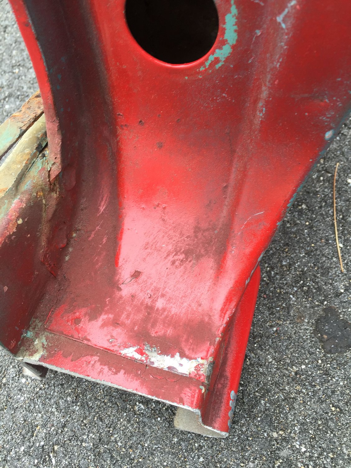

So I have some rot that I discovered down at the bottom of the front of the cab/firewall, basically where the inner fender stops. Looks like someone along the way slapped some fiberglass over it and painted it (nice...). I guess I will put this on the list of things to fix next winter. I looked around DC and LMC and didn't see any panels available, anyone know of anyone that makes them? I guess otherwise I will try to cut it out , bend up something myself and then weld in some new metal.
Here is a pic looking up from underneath. The outer fender is on the right side of the pic.
http://i379.photobucket.com/albums/o...psu35wqmaj.jpg

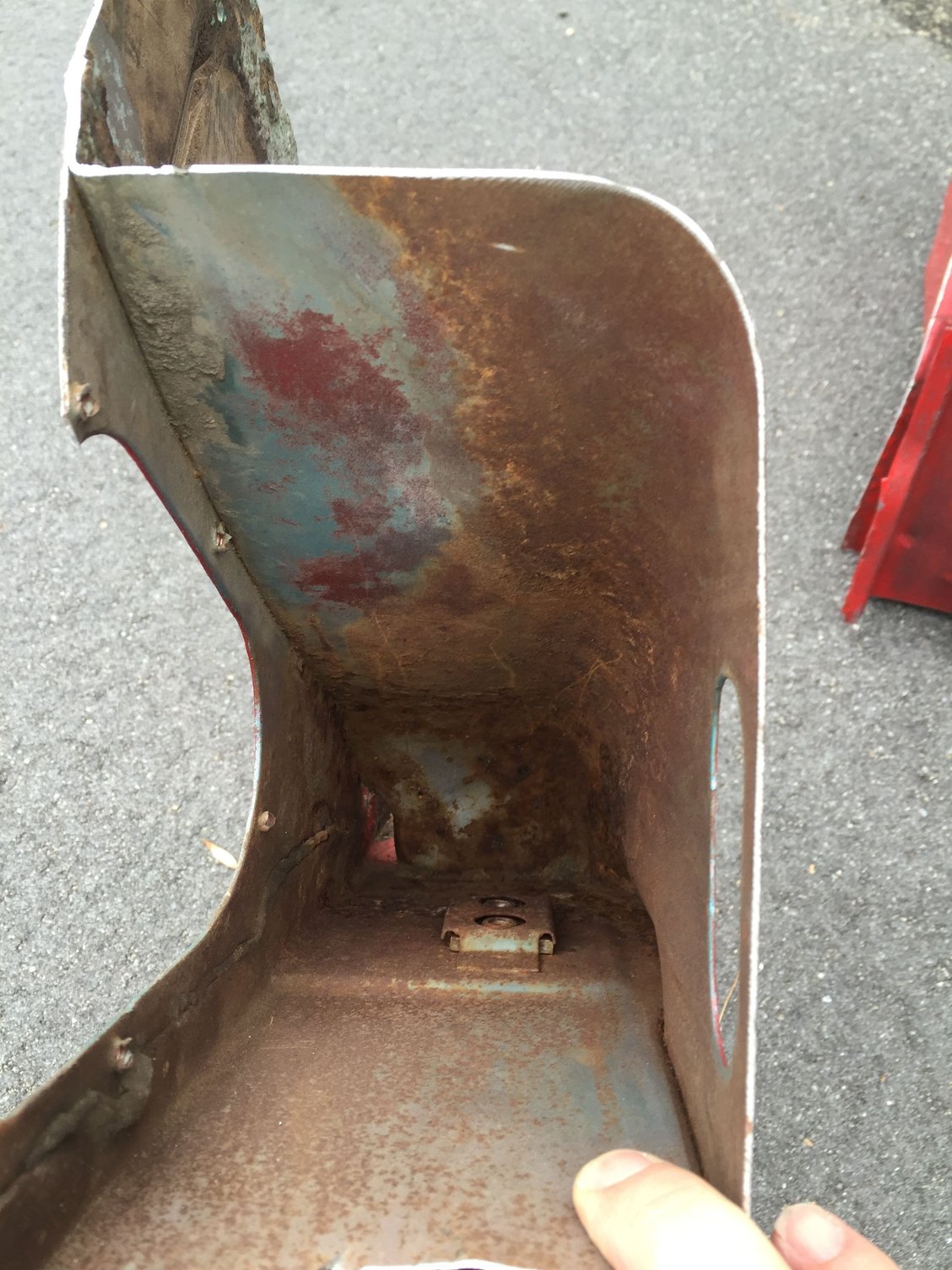

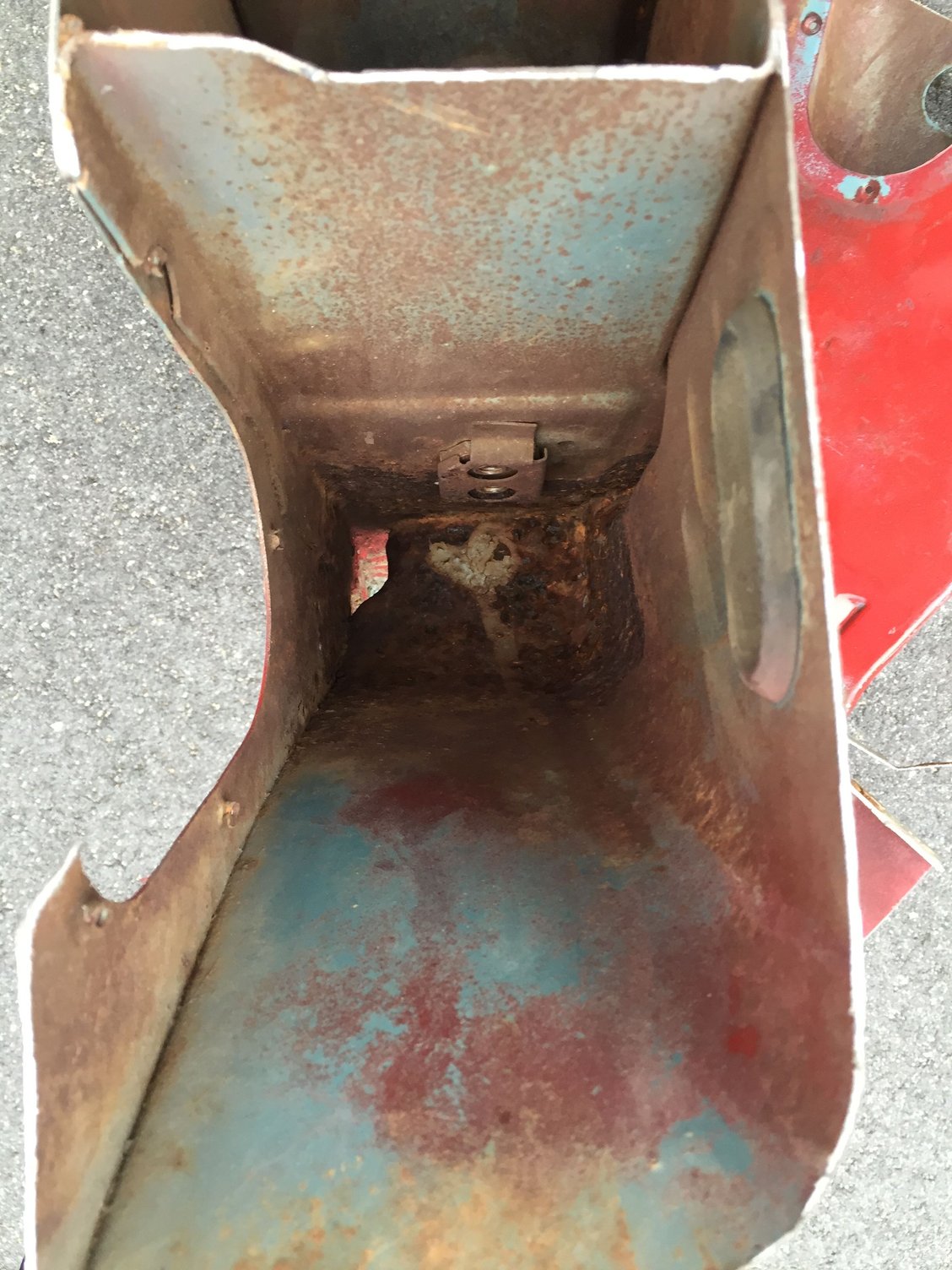

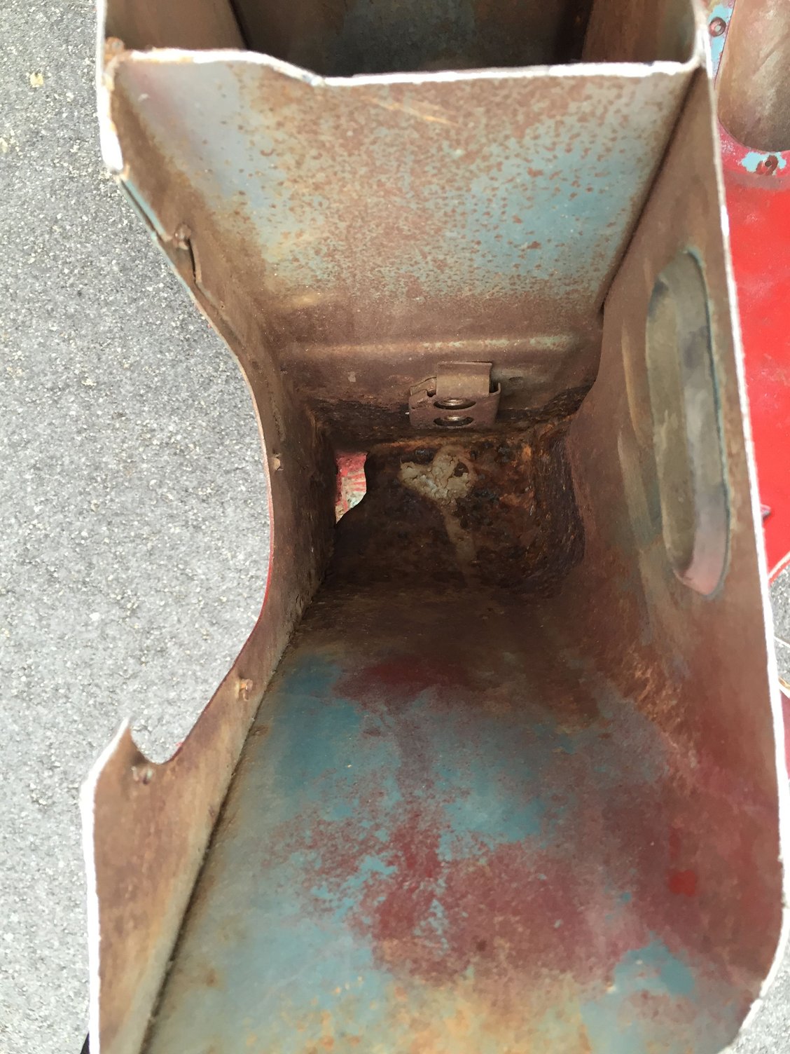

Have Cab corners for you
Hi - I have cab corners cut out from a California truck I don't need. PM me.

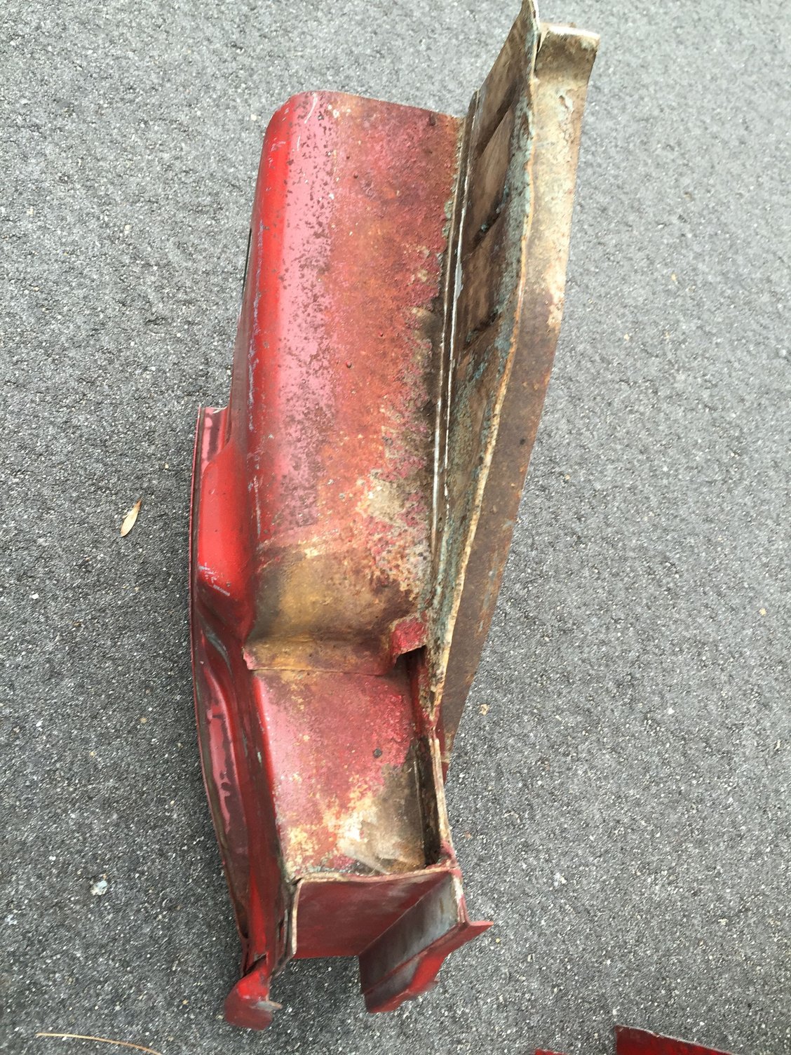

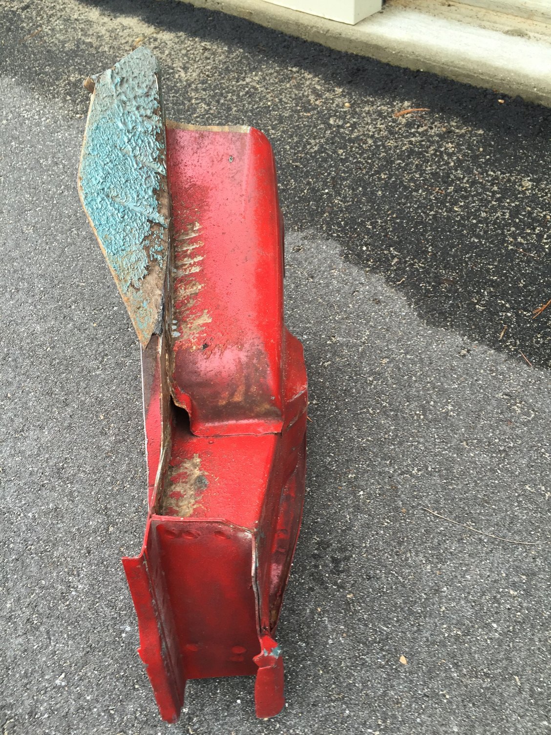

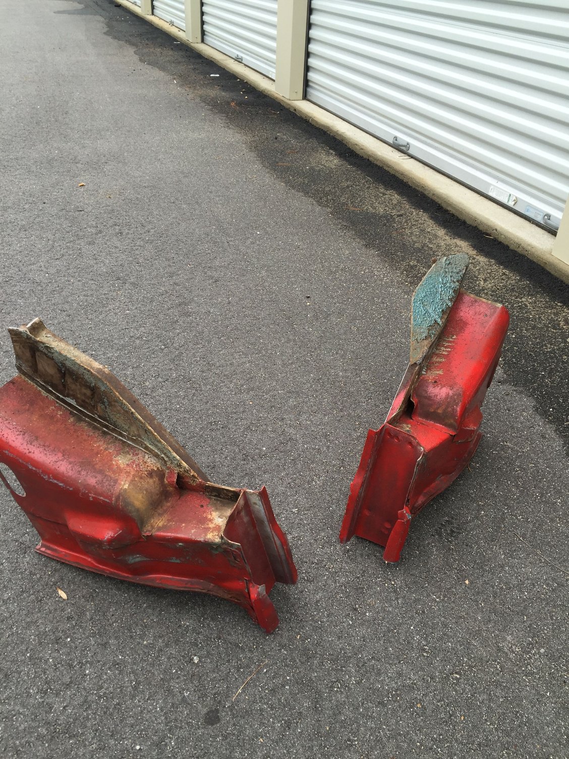

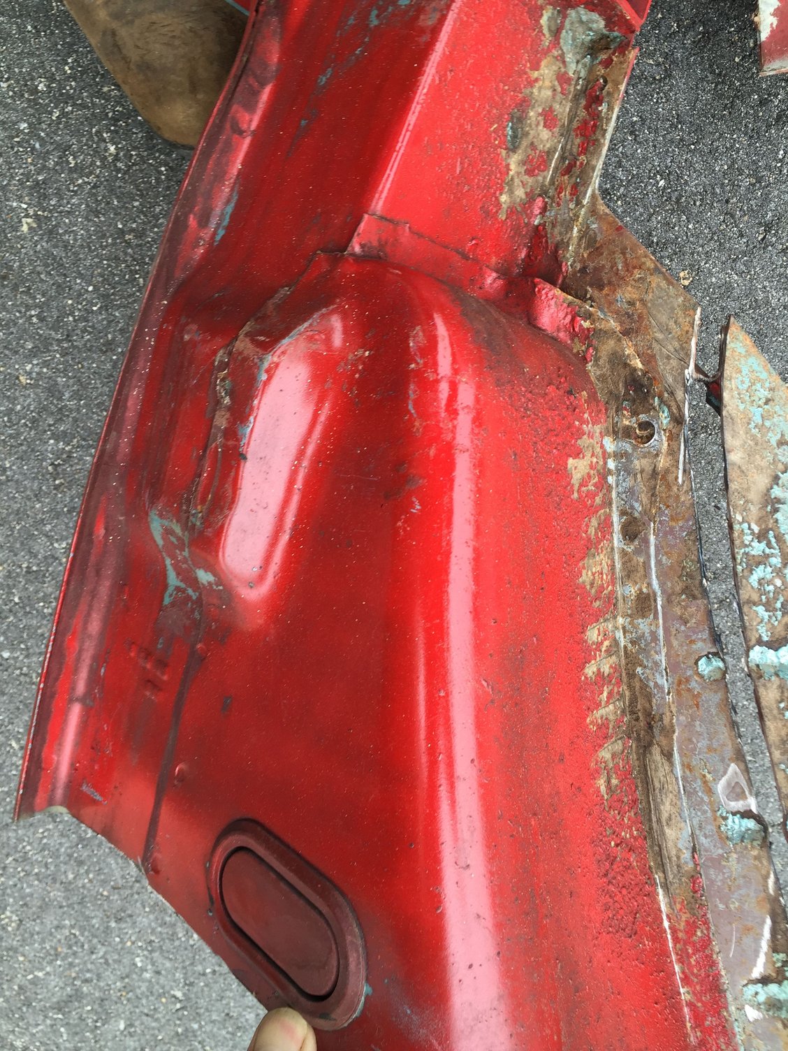

PICS are below. These are from a 65 or 66 but it doesn't matter for what you need. You will drill the spot welds out (with a spot weld drill bit) where my fingers are pointing to the spot welds - and end up with a perfect repair panel. Let me know, I sent PM earlier.

All I want is what I paid for them plus shipping. I paid $100 each, so its $200 for the pair plus shipping. I bought a whole different cab, so I don't need these and just passing along.
