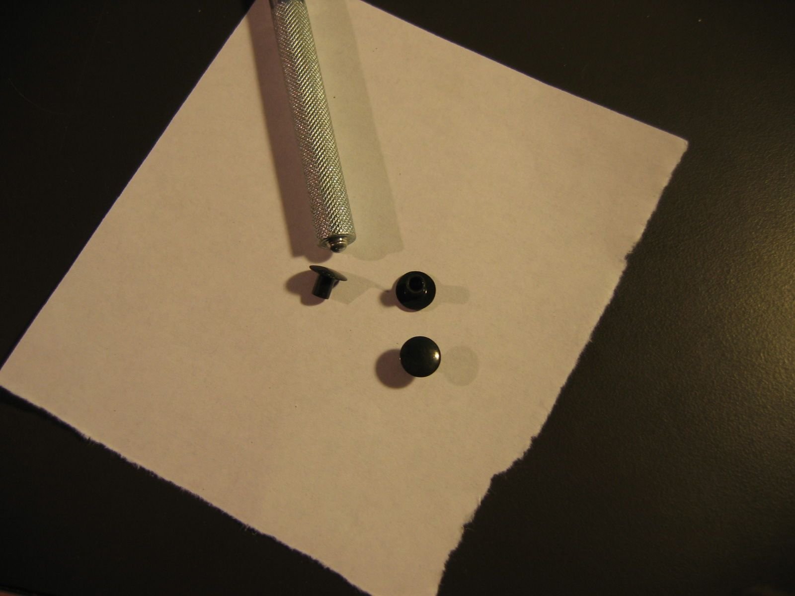

Question on these vent frames. What type of riviter do you use to install that threaded L shaped center post.
Old Aug 3, 2014 | 09:52 PM
P38fighter's Avatar
P38fighter
Joined: Jan 2012
Posts: 396
This an eyelet setting tool that I got at my local Michaels Craft store. The rivets came from Hanson Rivet part # D3-6-ST - BUT are sold in a bag of 100. You need 4. You may be able to find them individually at a local hardware store...good luck..
Old Aug 3, 2014 | 10:00 PM
salf100's Avatar
salf100
Joined: Apr 2009
Posts: 339
Ok thanks. I'll buy that tool. I have the rivets.
