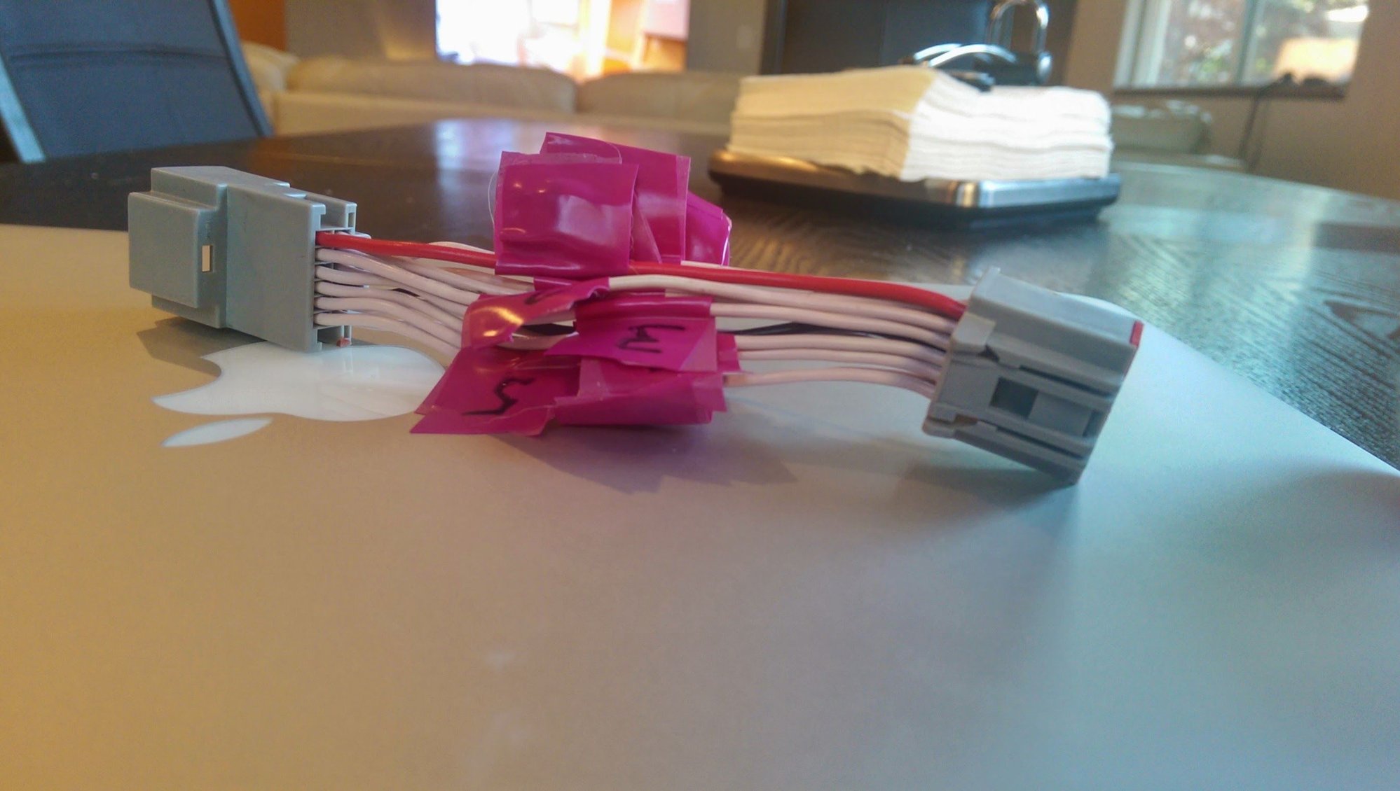

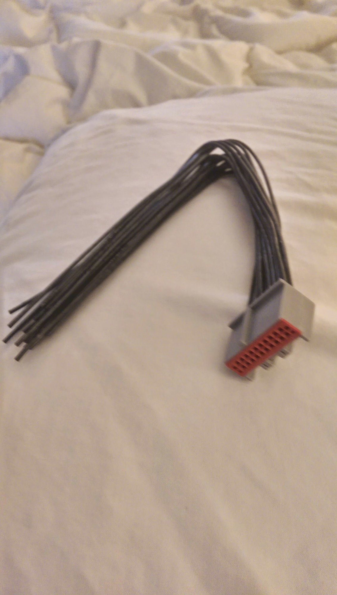

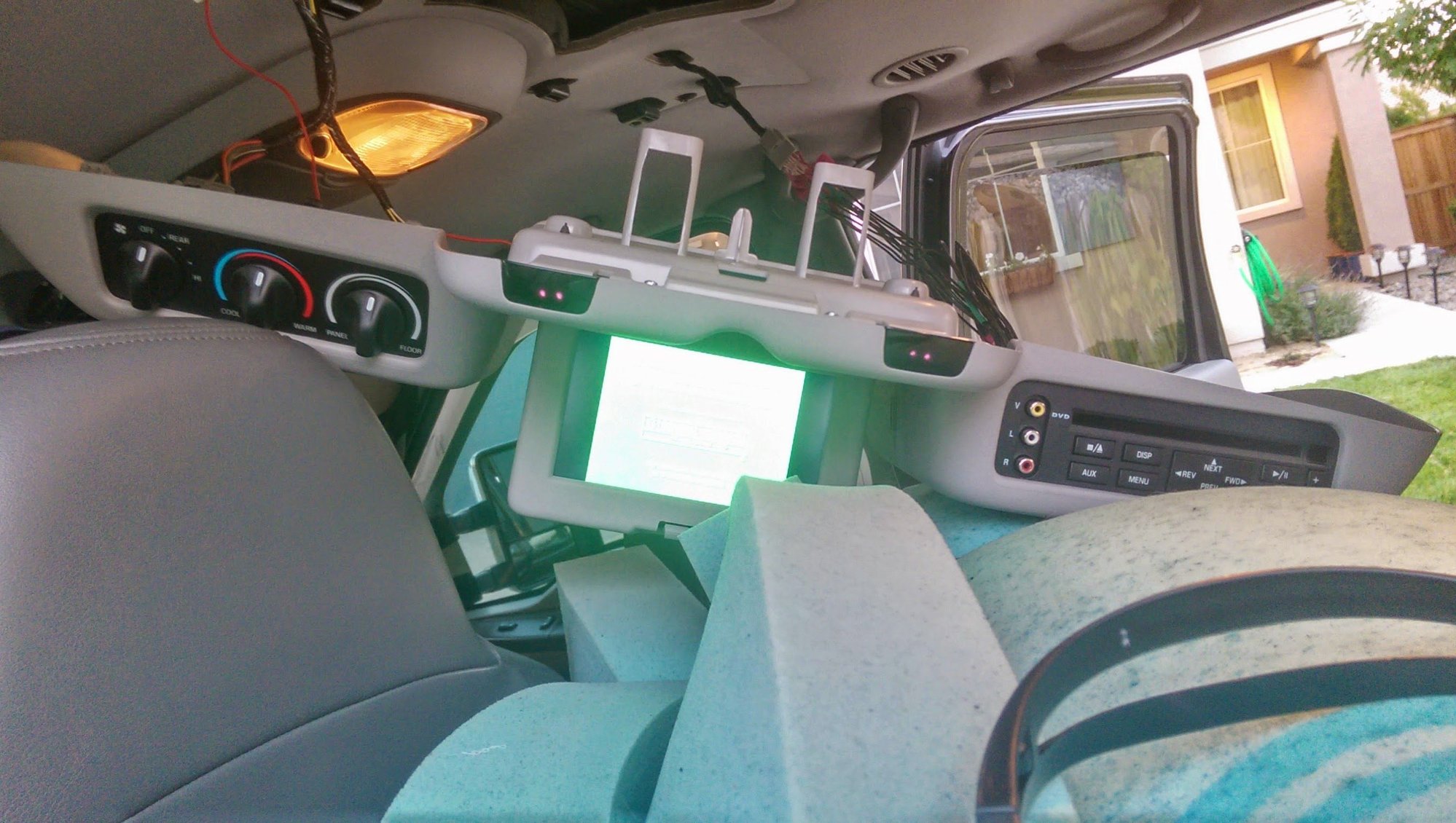

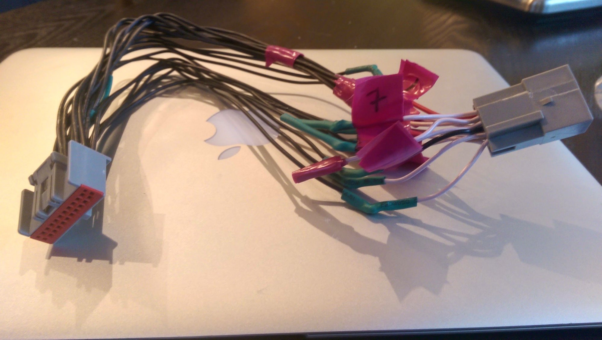

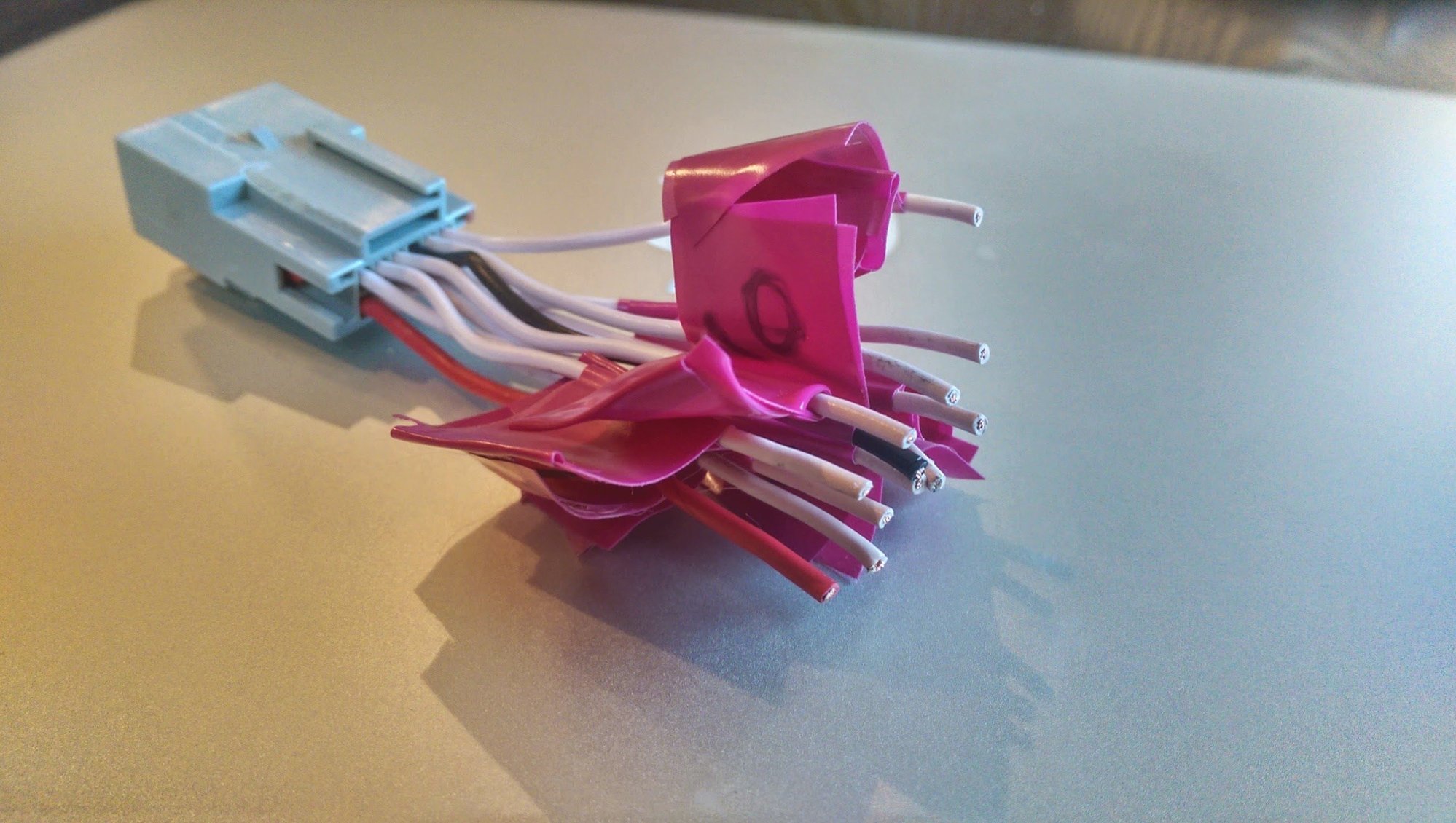

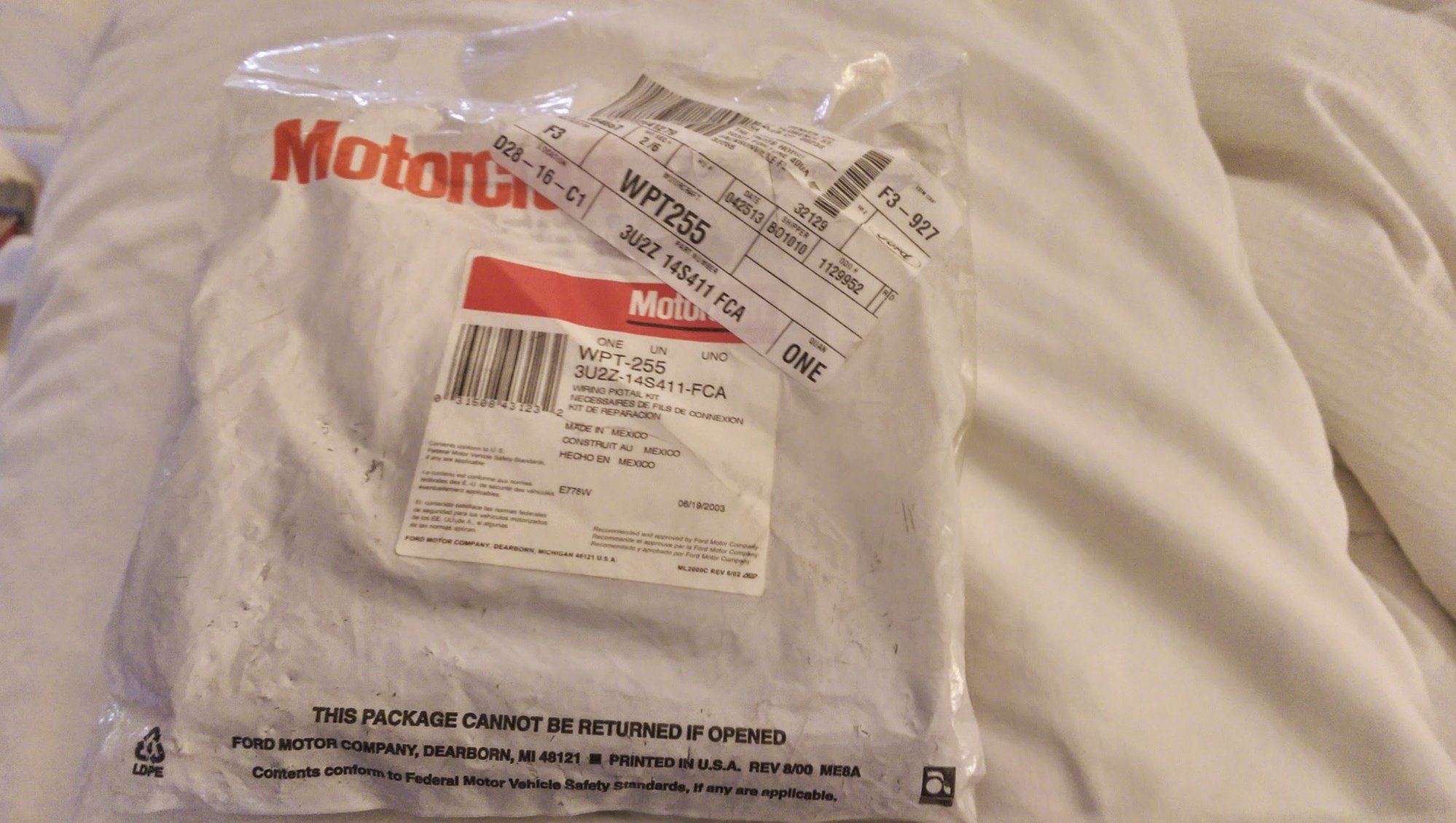

$32 Ford pigtail adapter
Existing 12 pin connector between roof and DVD (2002)
Labeled each cable so I could match them up
Ford Pigtail adapter
Cut the original harness - no going back now
harness wired up!
Checking if it works and success!
Doesn't take up any of the rear view
