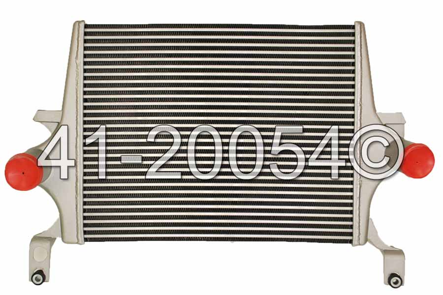

I did find some posts by guys saying they've hit the Banks one with spikes of 100psi on another forum with some compound turbo setups. I'm looking for something that will hang in the 45 psi range.
Edit:
I was hoping one like this one would work because it's about half the price of the Banks

I think you guys are missing what I'm trying to find out here... I'm going to be using a Ford 6.0 intercooler in an application that will probably see up to 45 PSI on a semi-regular basis and I'm cautious of the plastic sides. I'm wondering if the stock style with all aluminum welded on sides will hold up or if I need to spend the big money on AFE, Banks, Mishi for one that will live.

The plastic tube pre turbo takes next to no pressure, the tube post turbo, through inter cooler is probably good to 30 psi, maybe a bit more. The pre turbo is only atmospheric air being sucked by the turbo through the air filter, I don't know what negative pressure, maybe 5 - 10 psi. Better to change this out with solid tubes for larger boost applications. Definitely all aluminum tubes and radiator is the way to go. Mishimoto should be able to confirm their max psi rating. I have not seen one in person or the banks so can't speak to quality. I would like to do mishimoto one say, solid intake side tube and new boots one day. Probably do mishimoto but I am not planning bigger boost.

I have seen a couple of factory CACs fail. Both spit out the rubber o-ring between the body and the plastic end tanks. I would consider a one piece unit a good upgrade if you plan on upping the boost a bit. I have no experience with the aftermarket ones to recommend anything specific. An alternate plan might be to set aside the $$ for the one piece and see how the factory unit holds up.
