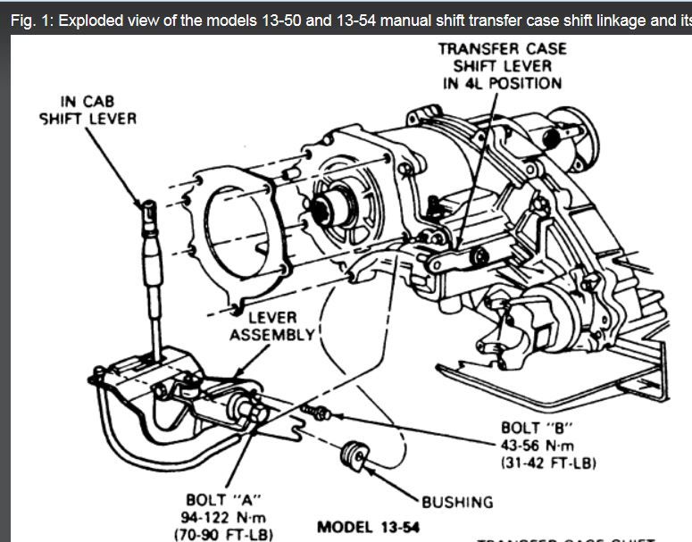

I've got a 1998 F-150 with the 4.6L and a floor shift transfer case...
The problem is that I cant get the floor mounted shifter to engage into 4x4. Its almost like there is something stopping it from going into 4x4 and not staying in it. Fluid level in the case is good.
Anyone have any tips, advice, tricks or information?
Thanks guys!
Jordan

Are you familiar with 4x4's? If so please disregard my listing the obvious stuff
1. Is the problem moving the selector from 2H to 4H or same problem moving to 4L?
2. Sometimes I have to back some trucks up just a bit to kind of take any load off the driveline
2. Are you a manual or automatic trans? manuals I normally am in neutral when shifting the transfer case but sometimes need to let the clutch out while in gear just a touch while pulling on the transfer stick.

Hey Phil,
1. It is almost like it is stuck in 2H, won't move past there.
2. I have tried backing up and it does nothing.
3. It is an automatic trans.
I have had the truck up on the hoist, sprayed the linkage with penetrating fluid, got a bit more movement but not enough to get it into 4H or down into neutral or 4L

Sorry Jordan I'm not too familiar with your xfer case. It does sound like the linkage may be bound up. You're probably looking for something simpler but may be disconnect the linkage right at the xfer case and see if you can shift right at the case (might need some channel locks or vice grips.
here's a site that describes the adjustment of the linkage
| Repair Guides | Transfer Case | Adjustments | AutoZone.com
