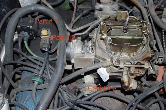

I looked at it today and it seems the "coffee can"
And all of this stuff
Only effects the EGR
My shop manual shows a "with amplifier" and a "without amplifier" image I am going to bypass all of this and hook it up per the without amplifier diagram:
EGR to output of PVS ported vacuum to input of PVS and see what happens anybody else have this set up?
If that works I can keep the EGR which seems like a good idea, especially since I have to in Cali for the smog popo, and I will have the evap system which also seems like a good thing, but I can get rid of a bunch of that spagetti!
I am sure the Engioneers at Ford had a reason for all of this, put seems like if I can keep what little smog equip it had and simplify the system that would be the best of both worlkds.

I have had this truck since september but still have not figured out what this is. Truck is a 1978 F250 460 with a motorcraft 4350 carburator. It has some black electric tape wrapped on it since I bought it.
D5TZ-9D474-F .. EGR Solenoid Vacuum Valve Assy / Marked: D5TE-9D474-F2A or F3A / Obsolete
1976/78 E250/350 & F150/350 460 CA emission / 1979 E250/350 & F150/350 460.
No OKC DSO code listed for 1973 and later Passenger Cars/Trucks.

Originally Posted by TexinCali
No kidding!
On the picture you are showing the vacuum amplifier and egr vacuum solenoid face are you susposed to have a two prong plug that possibly broke off on the front of the egr vacuum solenoid above the vacuum line ports? I'm in search of one because I have smog but a federal emissions in California. Mine was completely gone.
Found the right one. Your picture is of a broken one and that was what was trying to locate without any luck
Where its labled part 2 is the same as the one you are showing. This is a complete plugged in one
