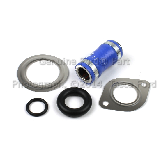

Anyone have the cross over part number for
3C3Z-9433-AB
It's the EGR gasket set.
I also will need the oil filter O-rings.
Thanks

1840701C92
Oil Filter O-ring is 3C3Z-6840-AA (don't have an Int # for it).

Oops - I do have the o-ring International #
1837498C1

3C3Z-9433-AB ~ MSRP: $80.05 / FTE Ford Dealer Parts Dept sponsor: horizonpartsguy.com price: $62.44.
3C3Z-6840-AA ~ MSRP: $16.34 / horizonpartsguy.com price: $12.74.

Do the gaskets not come with the EGR cooler or did you find a "used" one? You know those are all reusable, right?

You could always get the gasket set and return it if you're happy with the way yours look. I think my donut gasket under the intake was reused several times, as was the blue hose and intake gaskets. I did mostly new gaskets with the "new" motor "just because".

What parts in the set can be reused?
I am guessing that the two metal exhaust gaskets can't.
I am of the training that reuse was not a good option.
Like the intake gaskets are so inexpensive I would replace them

Actually everything can, especially the intake to head gaskets. Most folks don't want to hear it though--LOL. The only one that doesn't ring a bell for me is the small o-ring, and I never had a problem with the metal ones leaking.

I can see why it would be a requirement on an aircraft engine where a little leak can be a HUGE problem. Not so much on a Superduty though. Regardless, for no more than what you're doing I'd pass on the gaskets unless you think you're going to tear one up. I don't see any of them being a problem (knock on wood).
