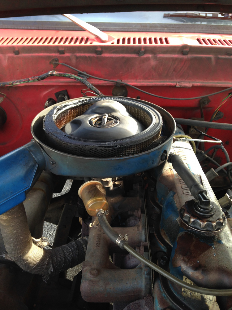

Hello all,
Yesterday while trying to start my truck (warm start), I turned the key and eased on the gas. The starter motor started to get stuck. I laid on the gas without thinking and continued trying to start. Before you know it, I saw flames coming out from under the hood and the carburetor was on fire.
We put it out with some wet beach towels we had handy nearby. After surveying the damage, we saw that the air filter was gone, a hose had come loose and the fuel filter suffered some deformation/slight burns from the flames but still looks functional. I've attached a pic for reference...
I have two questions, the first one being what could have caused this? After reading a bit I understand it could be a lot of things (timing could be off) but I think it's safe to narrow it down on account of some previous observations in the past, the first being: I've seen the fuel filter full with gas and leaking droplets of gasoline before and in fact I just now remember I've seen it catch fire before on a very small scale (I was messing with starter solenoid and some sparks had flew and ignited a spot of gasoline that was still wet after falling from fuel filter). Another thing I noticed was that I probably shouldn't have pressed the pedal as much as I did while trying to start and I might have saturated the air filter with gas, making it very flammable at that moment. But what exactly could have happened to cause that fire to start up? It was coming out from inside the carburetor ...
My other question is, why did that hose come loose? It looks like an important hose (I don't know the name of it if anyone can help), and I don't think the fire could have shaken it loose?
I appreciate the help,
bttf

Yer pic doesn't work and we have no idea what hose you're referring to.
Cause... well, it sounds like the rig has two of the three ingredients for a fire - air and fuel. Add a spark and, Voila! Fuego!
The excess fuel fumes prolly ignited (from cranking and bad timing) in the intake manifold chamber, resulting in an overpressure and a flame front which, in turn, blew off the hose, and ignited the fuel which was leaking. A backfire isn't necessary to be set alight.
Some hoses are slip (compression) fit, some hoses are secured with a spring clamp, and some are held on with a band clamp. ...Be a detective.

Fixed the image.
Interesting theory HIO Silver; I think that seems most plausible.
I think my next steps include fixing that fuel line so it doesn't leak anymore and replacing the air filter. Is it common to have the excess fuel fumes ignite when starting up? It seems like something that happens without noticing when the engine starts up as normal...

That is the PCV breather hose. I feel like a backfire will blow it off. I'd check timing. Make sure the inside of your distributor cap and rotor are clean.

The PCV breather hose if I'm not mistaken is on the back end of the engine. You can't see it on the picture but I'm almost sure; I posted a thread a couple months ago just asking what it was, and I was told it was the PCV...

You are correct. There is a pcv hose coming out of the back of the engine. The hose I pointed out is also for pcv. The back hose goes to the base of your carburetor. Manifold vacuum pulls blow by vapor out of the crankcase through it. The hose shown in your picture connects to the air cleaner. It prevents the crankcase from having negative pressure by pulling clean air into the crankcase through the air cleaner.

Anyhow, this morning I went to the car and inspected for damage. Other than some scoring on nearby wires, everything seemed in good condition. I replaced the air filter and gave it a start. She started up fine. Then I noticed some dripping. The fuel line was dripping near the fuel filter, right onto the engine block. Then I noticed that when I hit the gas the leak would spit out fuel towards the windshield; some droplets landed on my windshield since the hood was up. This I think may be the cause of the somewhat large fire I saw the other day.
