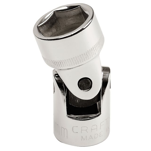

I used to do all my work on them from there, but working on an Excursion one time changed my whole attitude on those bolts (not accessible from the wheel well).
13mm flex socket:
