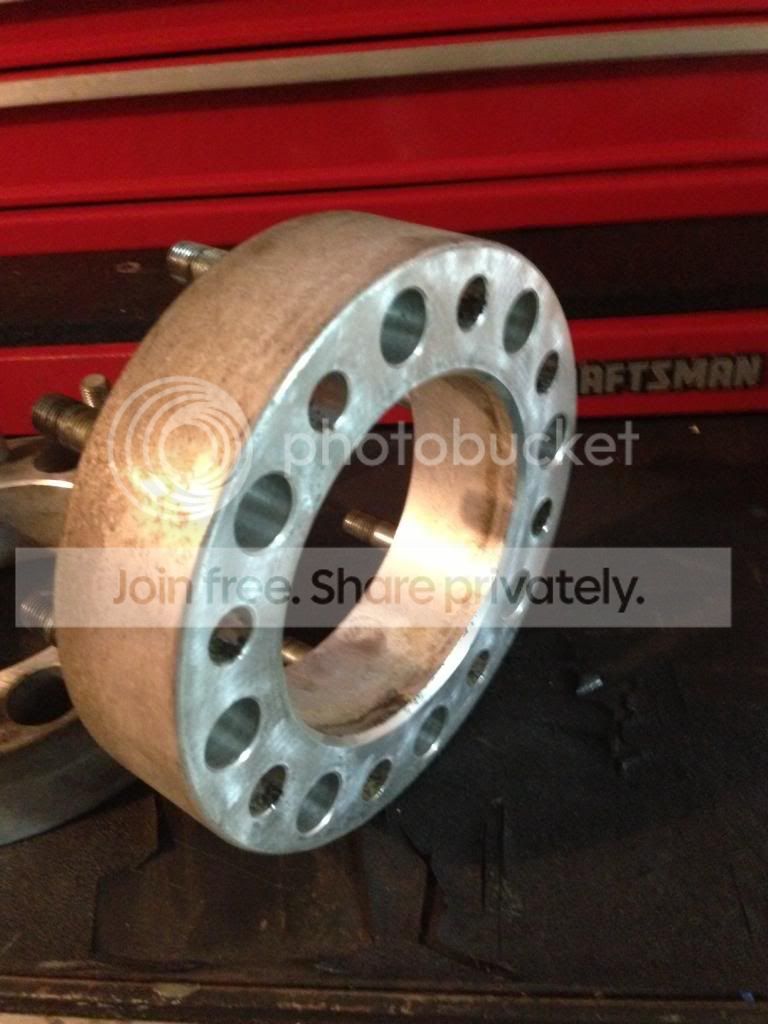

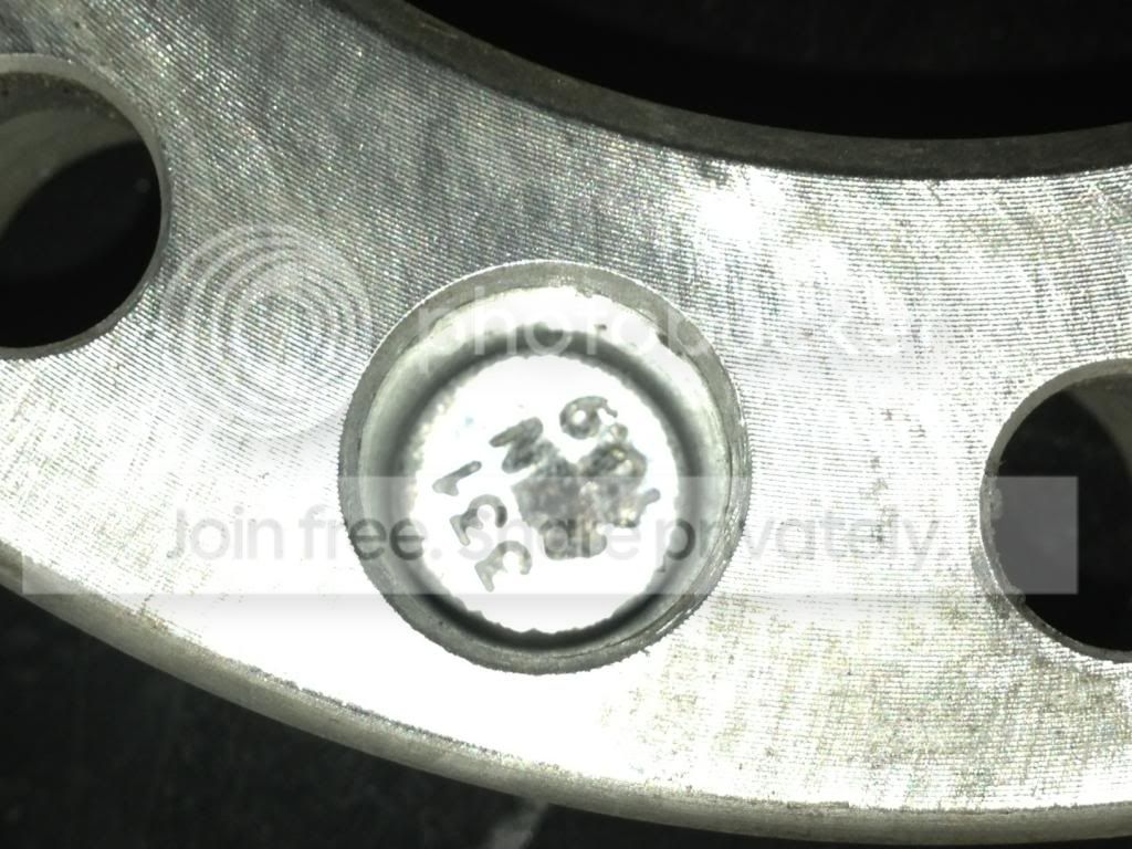

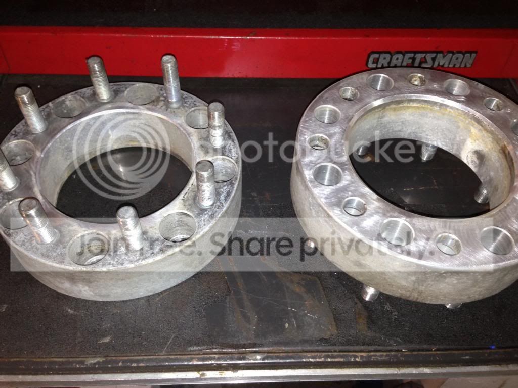

After a lof of headache I finally determined the front end vibration was caused by these wheel spacers. I removed them and the truck is smooth as glass now. I do however need a set for the 06 F350 wheels I run. These were on the truck when I bought them. I believe these are hub centric. Does anyone recognize them? I do not see any part numbers stamped or " made in China ". There is a number I can see shown in the last picture. They appear to be a quality part, but clearly they are NOT!

Those are not hub centric they are missing the centering ring to line the wheel up. They would be some of fleabays finest...

2nd that. They are not hubcentric. Just hop on eBay and grab a set of hubcentric ones and you'll be good as new

The proper hubcentric wheel adapters will have a ring on them that the rims center on. And if you want the safest adapters possible, buy the steel ones and dont look back.

Those spacers you have center themselfs on the hubs, by looking at the rust ring in them, by the wheel side of them is made for lug centric wheels like alot of aftermarket wheels are.

Our trucks are all hub centric so I would go with that setup. Many aftermarket wheels are lug centric because they like the one size fits all concept and they don't have to worry about fitting so much.
