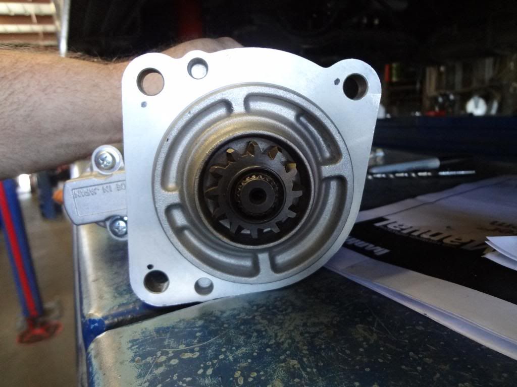

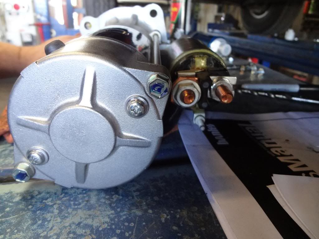

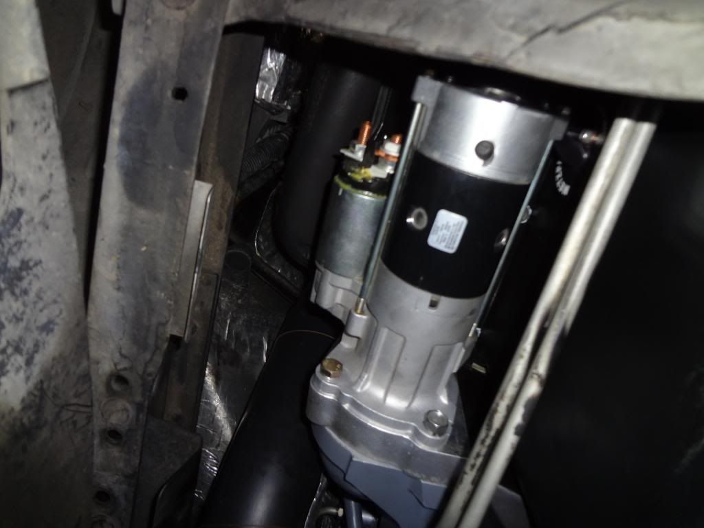

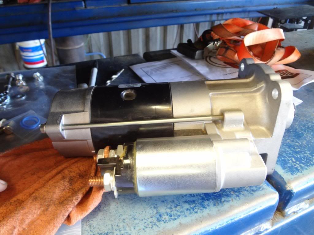

It will work no problem. Mine is a Mitsubishi 3-bolt for the 7.3L and it bolted up nicely, and from all indications thus far it's a strong unit. Here are some images. If you have more questions post up. Good Luck!
