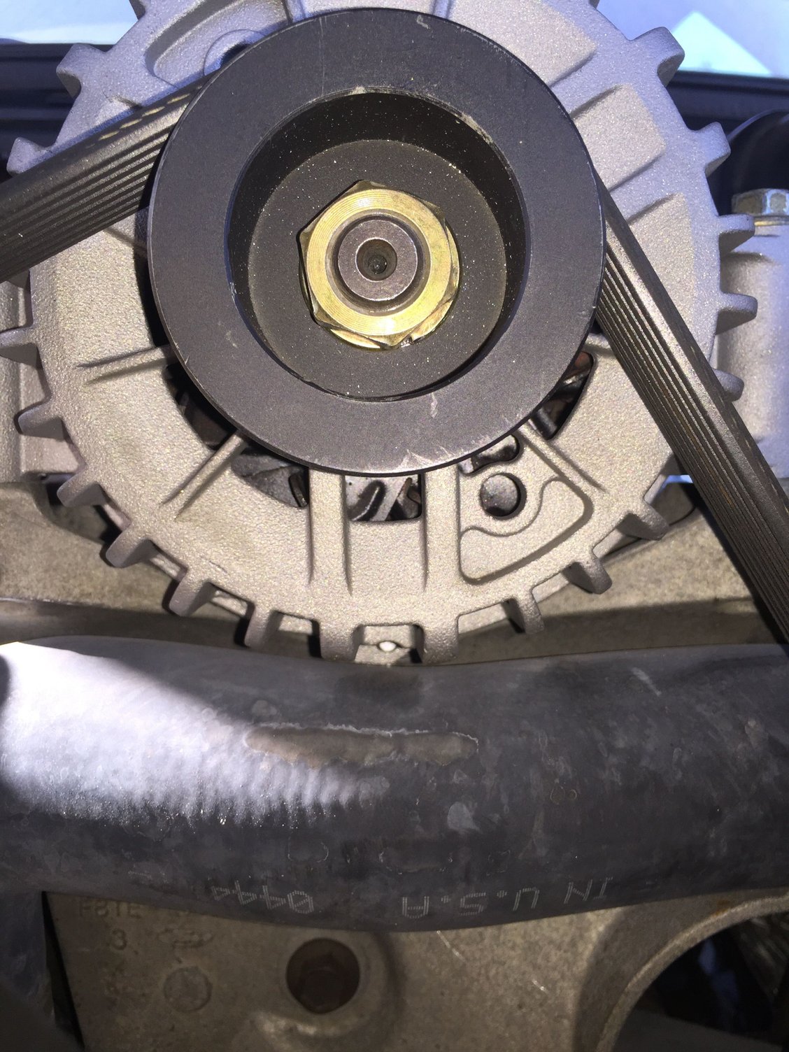

Please see the attached picture. It seems like my newly installed 6.0 alternator with its oversize alternator case is just barely touching the around-the-belt upper coolant hose. I think I'm going to have a problem as the alternator heats up. Not sure that loom will solve the problem. Other than changing back to the old style hose, does anyone have a suggestion.

I'd put a rubber hose of some kind between them or go back to the old style hose.
If clearance is an issue you're worried about, trim a little off the hose where it clamps onto the neck above the thermostat. 1/4" or so should be enough to change the angle of the hose and give you a little breathing room.
I forget. Will I lose fluid when I remove the hose? Stated differently, do I have to drain the system ... again?

You'll loose some fluid, but not a lot. No need to drain the entire system. Lower hose would have been a different story, but upper hose isn't too big a deal.
