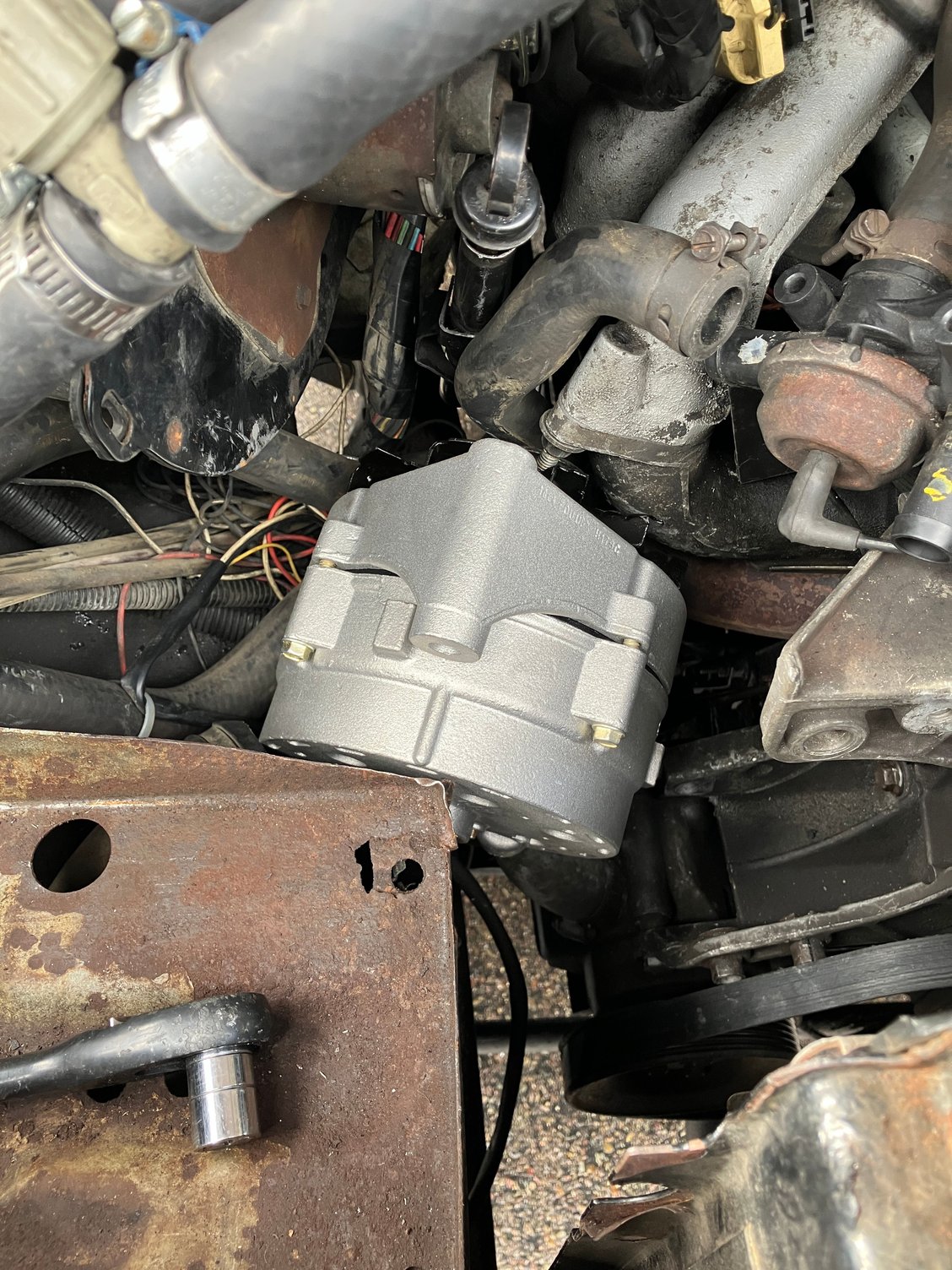

Old Feb 7, 2024 | 04:51 PM
Vokaty's Avatar
Vokaty
1st Gear
Joined: Feb 2024
Posts: 1
Super tight but worked for me (100A)
