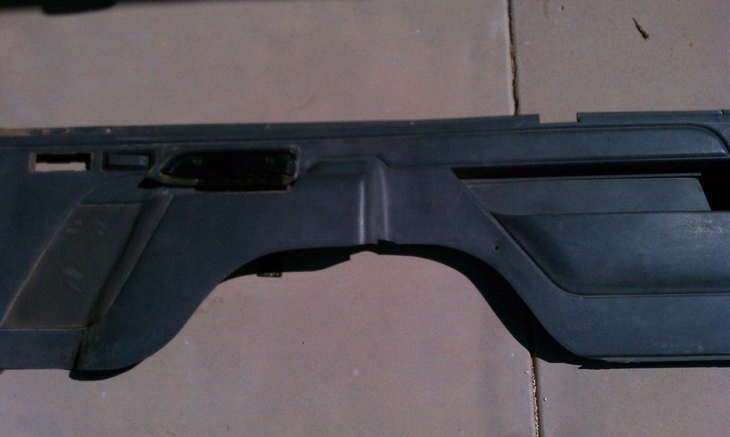

One of the biggest issues was the rear paneling.. it was just black cardboard stuff.. well now, after some searching and painting, I have finally found some!
Alright enough talking(typing) and here are some pictures. I'll post everything I've done to this point that I have pictures of and plan on posting more!
Here's my crappy stupid looking old beat up paneling:
Here's some paneling I found at a salvage yard in decent shape.. a little dirty though:
After a thorough cleaning with detergent, and grease and wax remover, then some Ace Hardware spray paint:
Here they are in my truck!!

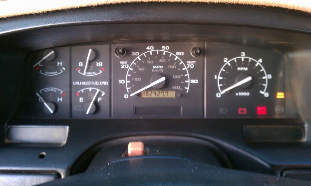

Also, the first thing I did which I find necessary for a manual transmission, a tachometer!! I followed the writeup I found on this site to get it installed so I have my original odometer. That writeup was how I found this site!

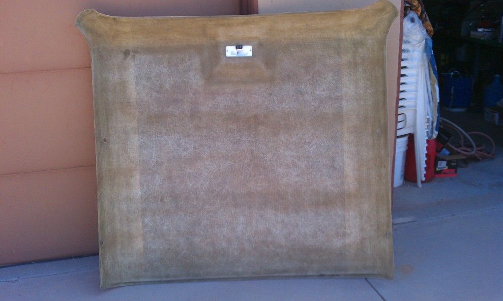

Anyways, I took some picture of the headliner I pulled from the yard.

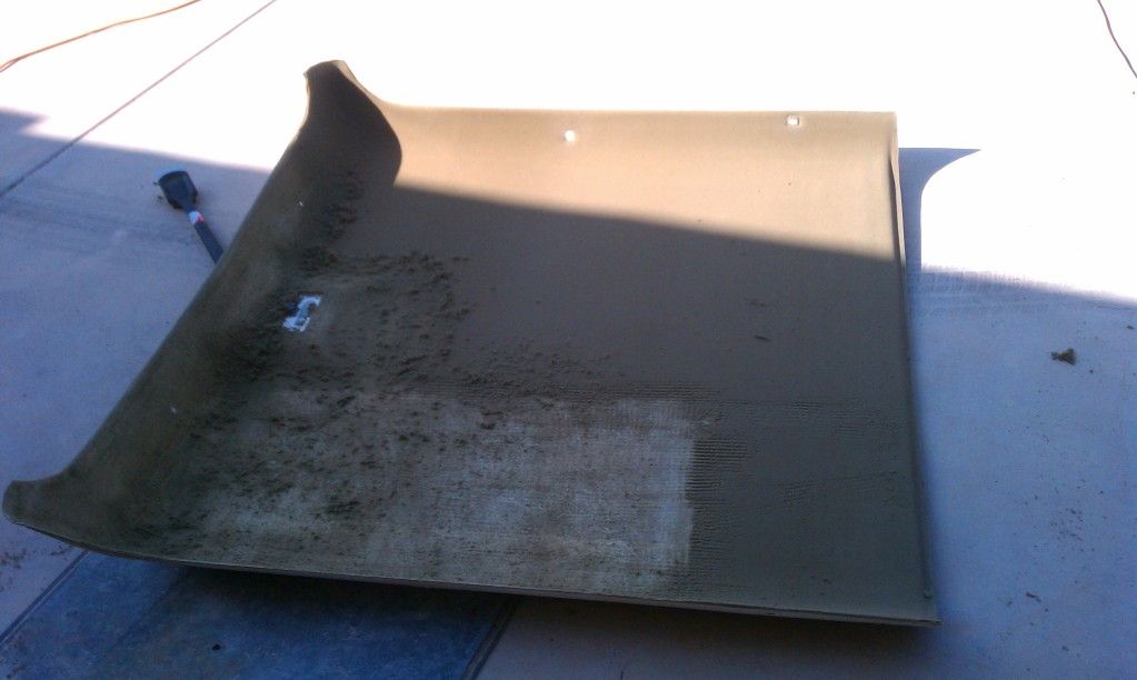

Here I pulled off the old, sagging blue cloth and started to scrape off the leftover foam:
Finally after about 1 1/2 hours of scraping, it's ready for the new headliner:

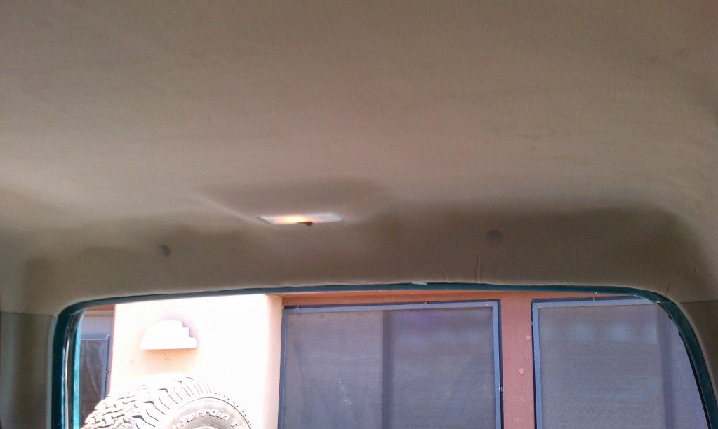

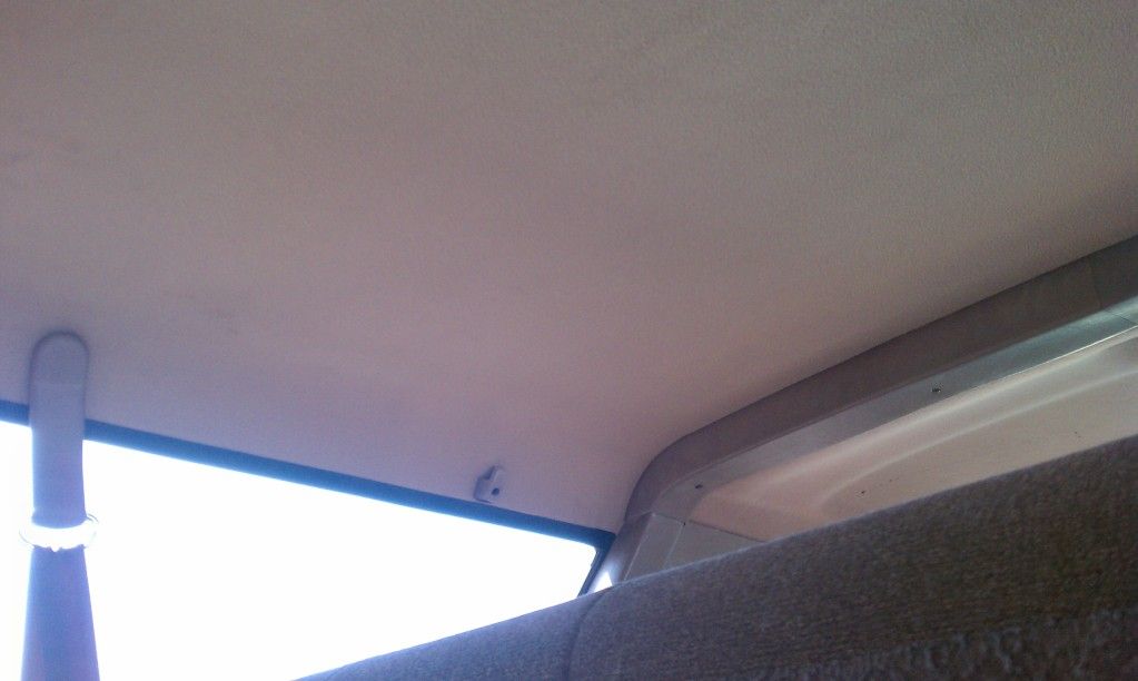

Alright.. being too excited to finish, I forgot to take pictures of my interior before the headliner, but I took some while reupholstering it and after!

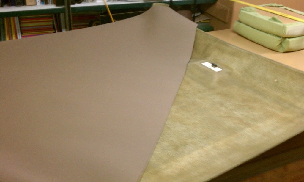

Here is the new material laid out across the headliner:

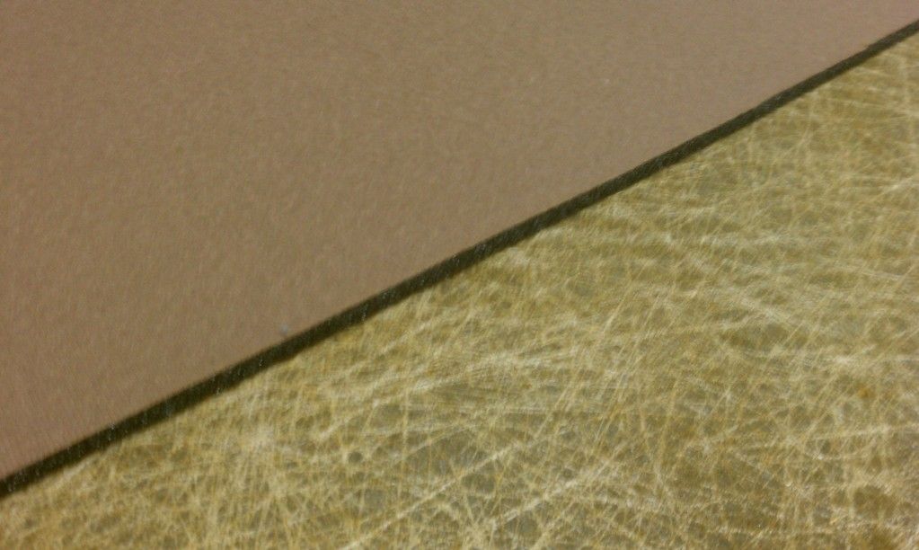

You can see how thick it is with the foam backing:
Here are the sides after installation:
I kinda messed up on the back, there are some small creases and I didn't fold the material super tight across the back because I wasn't sure if I would cut, or fold it over, but I think its still pretty good:
Overall, even though I kinda messed up with the back, I think it looks really good and it's much better than having no headliner, and now I have a working cargo light! I think the bulb I picked up from the yard is starting to die, but those are super cheap.
I'm surprised how much quieter driving seems now too. I knew it would quite down some noise, but it muffles the outside sound quite a lot for that one piece.
Now my next project will be to get bucket seats and a center console!!
