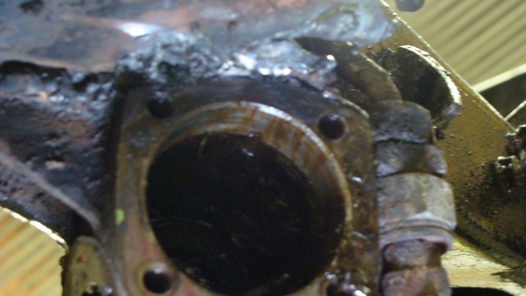

I was thinking the same thing. I'm going to have them email me some more pictures. I only really need the worm gear and cover to the bottom of the shaft. The previous owner (my grandfather) welded the box and cover to the frame. This messed up the bottom cover. I think The box can stay though.

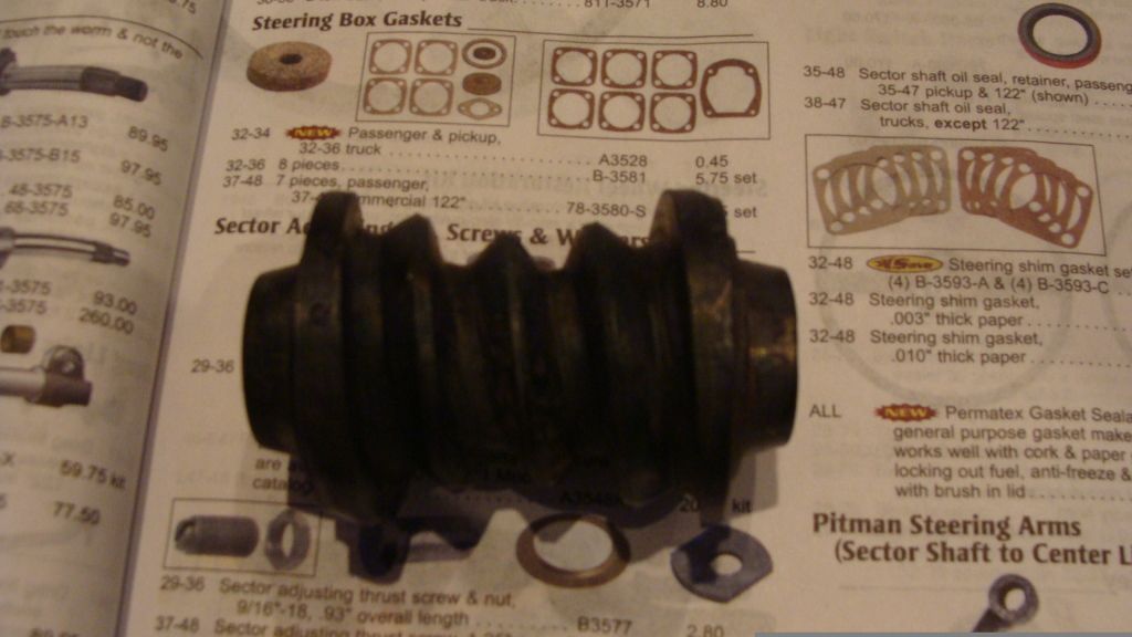

Okay... need more help. I got it all apart. I need to order a new worm gear. I don't see a serial number. Just a stamp of "82" and a a diamond with the number "6" in it. Which one do I need? HELP!!!

Originally Posted by christurney77
Bill, I'm needing the lower cover with the rod that aligns the steering shaft. The original was no good. I didn't see that on item on earlyfordstore's site? I had planned on purchasing the worm gear from Mac's.
On the above box.... Is the cover made the same as with my box?
Same Ford part number.
11A-3597 .. Tube & Plate (cover) Assy (steering gear oil retainer) / Located at the bottom of the steering column.
1940/48 Ford/Merc Passenger Cars // 1940/47 Commercials & 122" wheelbase trucks.
CARPENTER NOS OBSOLETE PARTS in Concord NC has ONE = 800-476-9653.
FoMoCo did not sell the worm by itself, was only sold as the steering shaft & worm assembly.
