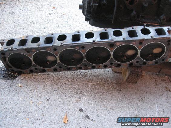

An update.
I found a parts truck locally that I bought for $300. Had a running 300 in it, as well as a few other odds and ends. (More on that to come. I just finished swapping my SROD for an NP435!)
While I had everything apart, I put the engine from that truck into my Bronco so I could rebuild the one I had in there. It was clacking really loud and making way more noise than I was comfortable with, and I didn't trust it. I also didn't want any screwed up valve train geometry damaging the port and polished head I put on there.
Anyway, started going through the motor last night. For a refresher on the back story, after my cam bit the dust and I pulled out the original engine (the one that couldn't be rebored), I found this one on Craigslist for $50. It was pulled from a '78 and had unknown miles on it. The guy simply pulled it because he wanted to go buy a brand new engine and throw it in.
(The copper is the head gasket).
Aside from some carbon buildup on the pistons, everything looked to be in amazingly good shape. Turns out that it was the cam and lifters (go figure) that were making all the noise. I could wiggle the cam timing gear slightly up and down.
The piston walls are all clean as a whistle. No grooves or the like. Very nice and smooth. Also, there is virtually no lip/ridge at the top of any of the cylinders. The cylinder walls have almost NO wear on them, and these are the original pistons. The compression, when I tested it, was 160 per. It was just burning a lot of oil, so I'm assuming the rings were bad.
Also, unlike my last engine, there is absolutely no wobble to the pistons. They are tight as a drum in the cylinders!
Unless there's something I'm not seeing, I don't even think this engine needs to be rebored. I haven't removed the crank yet or inspected the underside, but I also don't think I need to get new pistons either, unless I just want to have them new.
All the cam bearings look good (I'm assuming it was the cam itself that wore down, so a replacement will do just fine), so a new cam and bearings will fix that right up. A polish on the crank, and put it back together. I might have a very inexpensive rebuild ahead of me.
The #3 and #4 spark plug holes continually had a small amount of oil around them and this looks like it shows those cylinders (including #1) were having a problem with oil. The spark plugs also had a buildup on them. I'd posted something about it earlier this year when I removed the spark plugs and I'd cleaned them up then, but it looks like it came back.
So, I'm dropping the head off tonight to get checked over and cleaned up (since it only has around 5000 miles on it), and then it's time to disassemble the block.
