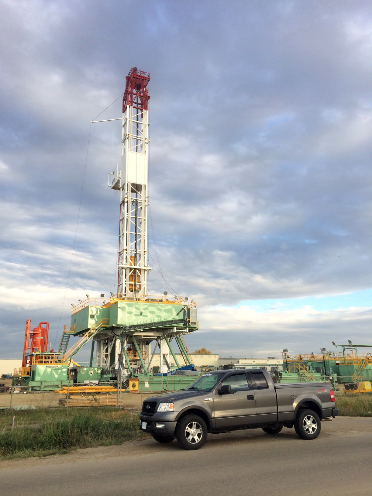

Originally Posted by AbandonedBronco
I have since then gone back to school to get another degree in Computer Science.
My sister got a major in Computer Science and ended up being on the team that programmed the drilling operations software on the rigs I was working on.
Attachment 290851

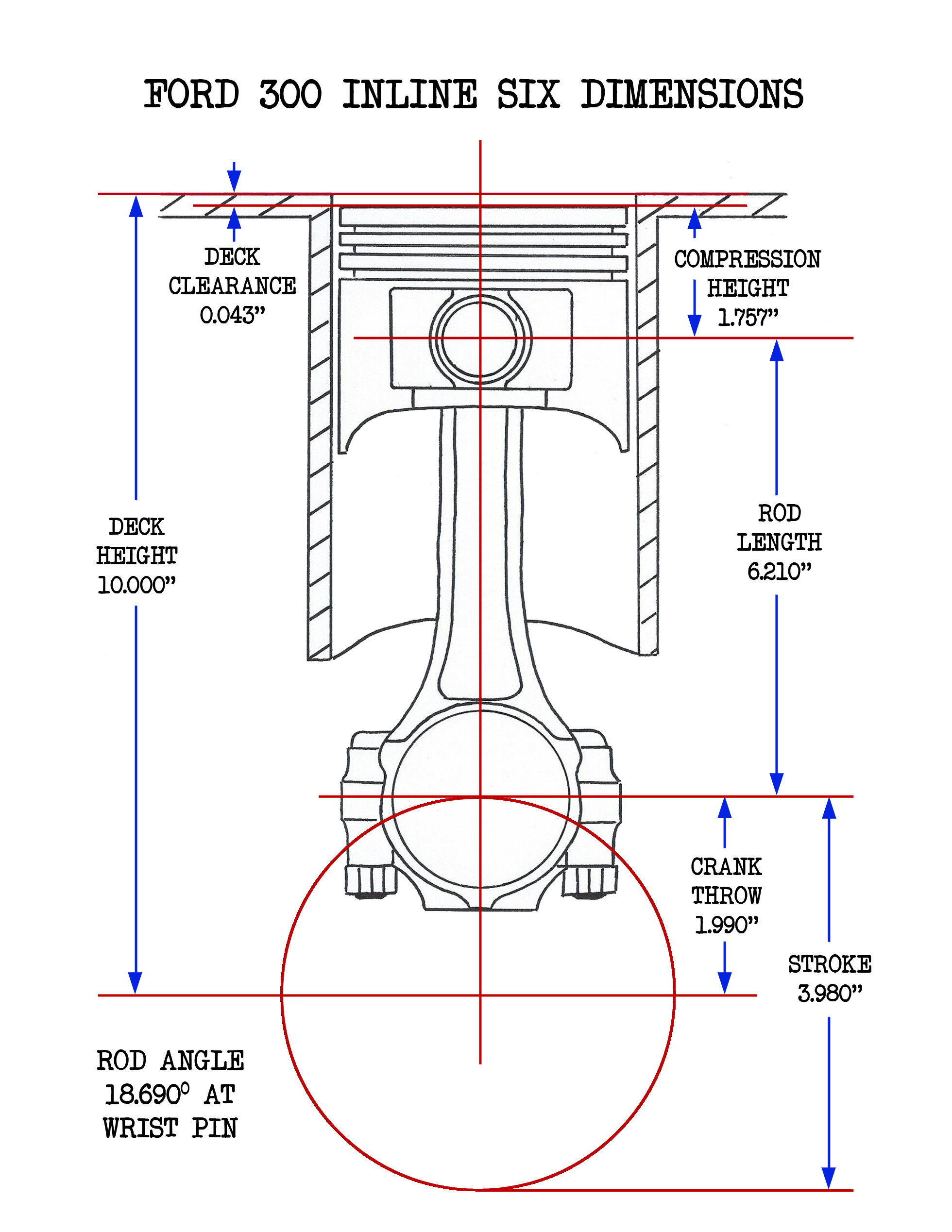

It's all math in the planning stage, and you're soon to find out why building an engine is completely different than a simple rebuild.
Compression depends a lot on what fuel octane you want to use. It has also been proven that compression alone will hardly do anything to improve performance but it will however significantly help you when you build the rest of the engine to match. If you want to stay on 87 octane you should definitely keep it under 9:1 compression, I'd say, but others might disagree and explain why. The 300 is funky though and anything above 10 pretty well calls for race fuel, so if you're in that middle range you'll need higher octane. A lot of people seem satisfied with the compression ratio that the 240 head offers, so let's do some math.
Attachment 290813
The above is a factory 300 engine's dimensions. Knowing this, and knowing that a 240 head has a 68cc combustion chamber, we can work out through online compression ratio calculators that this 300 would have a compression of about 8.7:1, rounded up, assuming the piston dish is 22cc and the head gasket compressed thickness is .040".
The easiest way by far to raise compression is to shave the head, and since you're using a 300 head (I think) with 76cc combustion chambers, and that each .010" shaven off a head on a 300 is equivalent to 2cc in combustion chamber thickness, you would need to shave off 0.040" from your head to be at the equivalent compression of a 240 head. Do you want to stop there? I'm not sure. I don't know what your goals are.
Now, a smart man who says, "Hey, I want higher compression but the last thing I want is autodetonation" would figure that he needs to make sure that quench is on his side, and since this smart man knows that .040" is considered the best quench distance and that an aftermarket head gasket for the 300 compresses to 0.039", he would need to zero deck the block, which removes 0.043" from the block. This is roughly the equivalent to shaving the head 0.040" and he has the added benefit of having better quench and therefore a smaller chance of autodetonation. The obvious problem with this though is that his man will need to take his entire engine apart and give the machinist a bare block.
I would personally zero deck the block no matter what, and if you wanted more you'd be left with two options: 1) If you're on a budget, shave the head or 2) If you have some money, buy some fancy pistons.
It all depends on what you want to do, and the more of what we know your goals are the better we can help you.
