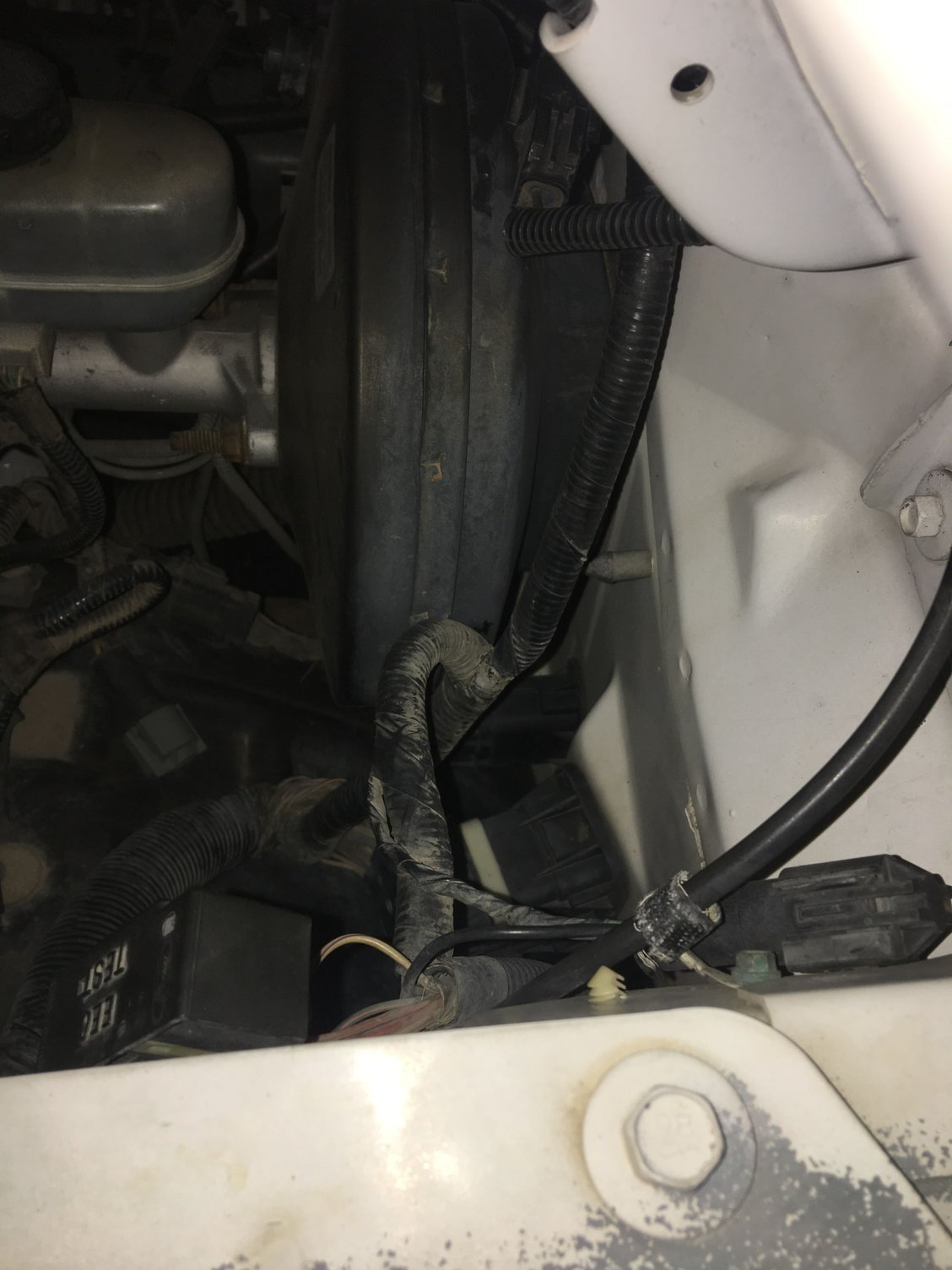

Old Mar 10, 2018 | 10:29 PM
  #119
EllieMae94's Avatar
EllieMae94
Joined: Dec 2016
Posts: 854
Likes: 39
From: Mid Missouri
This isn't the best picture for what you are looking for, but this is a pic of mine which DOESN'T have the needed connector in the wiring harness. If yours does have it, and if my memory serves me correctly, it would be right around where the "Y" is at in the wire loom (middle of the picture). Hope this helps some.
Old Mar 11, 2018 | 09:07 AM
  #120
Ruckin69's Avatar
Ruckin69
Joined: Jun 2016
Posts: 387
Cruise
This is what I have as far as connections by my master cylinder.
