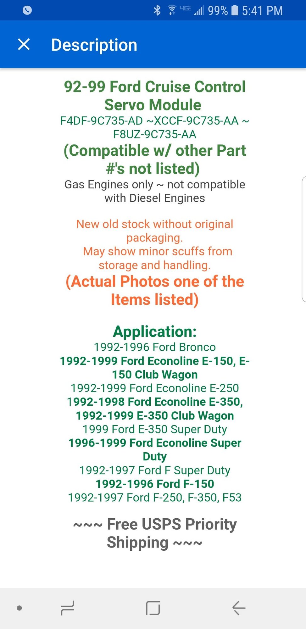

Servo part number
Found interchangability as per ebay
